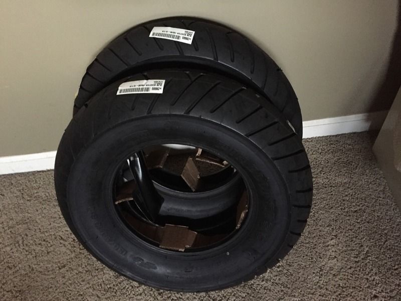

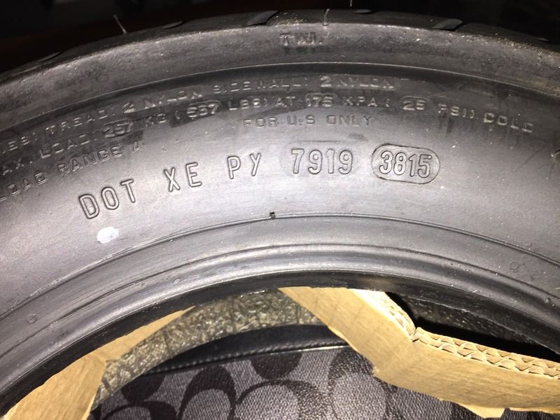

I just received two Pirellis from MotorcycleSuperStore this week. Can you tell me where to find these dates codes? Thanks!

Search date codes on Google it's a four digit code by the dot info

I did just that. At the end of the DOT number there is a four digit number that indicates the week and year that the tire was manufactured. Mine were made in the thirty eighth week of 2015.

Thanks for the info. Nice to see my new tires were manufactured within a year.
+1 on Motorcyclesuperstore they have the deal on the SL26's with free shipping!
