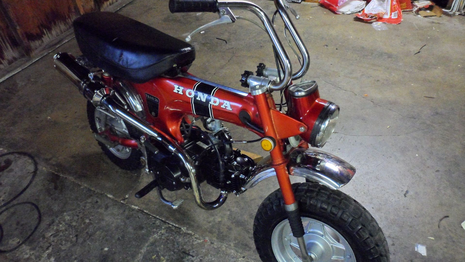

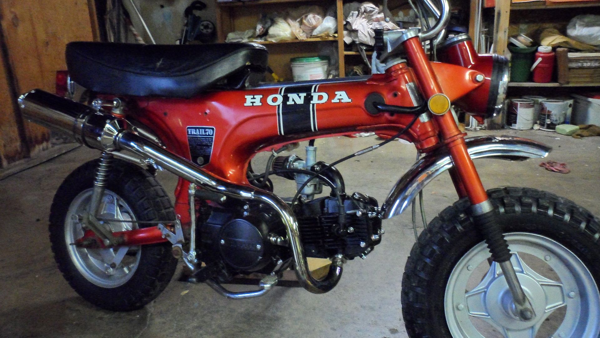

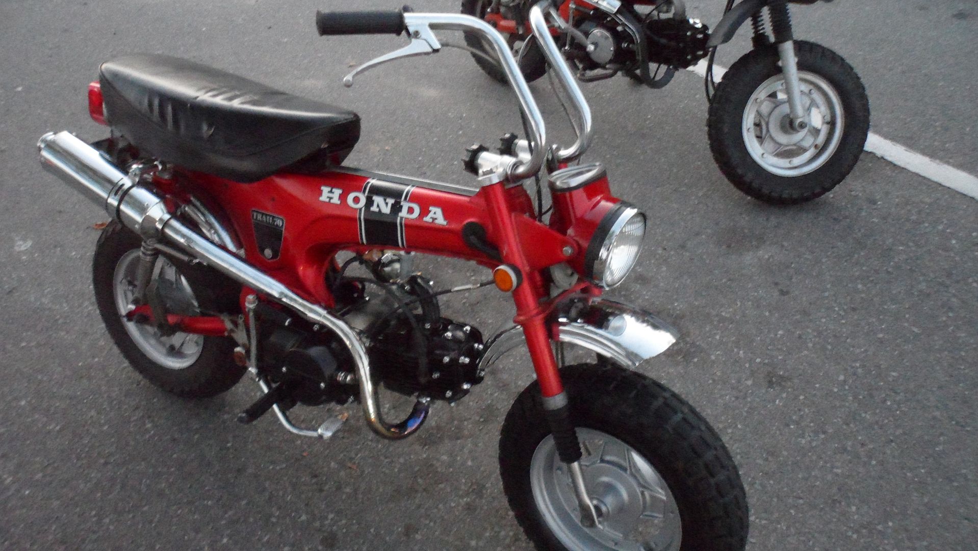

My dad bought this to go ride with me on trails. I plan on buying this from him later once he finds out he doesnt like it. But im having him put my name on the title now so I wont have to do that later.
Its street legal here, even has a plate. And it came with the original plate too all tore up.
Now it has a newer plate on it.

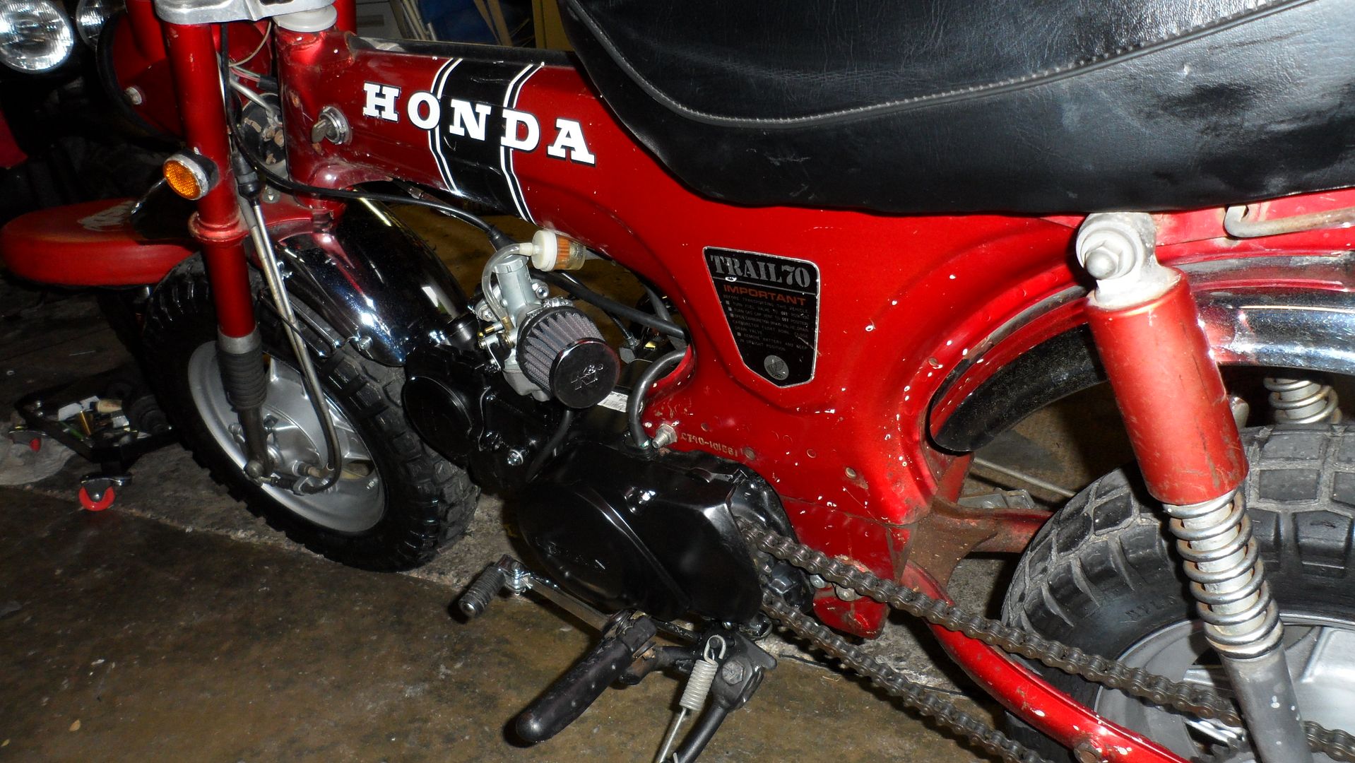

The guy put in a 125cc lifan engine. The exact same I have in my dirtbike too.
But because of that there are some little issues.
First when we were looking at it the father couldnt keep it running. It was the pilot jet clogged. So I took it apart on the spot and got it running. They used no filter. No petcock. The tank has 2 lines, reserve and primary. They put both lines on a T.
What im concerned about is the height on the carb the fuel has to go into. The original carb the petcock was on the bowl so it was gravity feed. Now im going up hill a little. Maybe only when its really low this may be an issue.

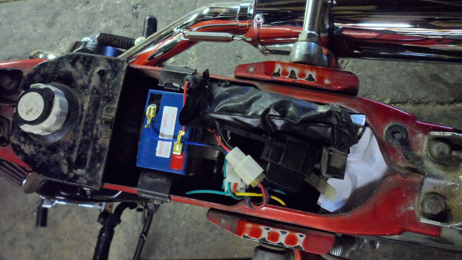

I took it for a ride went pretty far and on the way home its pouring rain. It started to stall at stop signs. I thought maybe it was the open filter but ended up being the 2 lines in the frame were pinched. One line was totally pinched.
When I got home I saw no fuel flow and pulled the tank and fixed it all.
I have ordered a petcock. Im going to use the T still this way fuel flows from the lower nipple too.
Now its flowing good.
The bike's tires are really cracked, must be original. But it uses innertube so I feel little safer cruising on it until I get tires. Had to replace clutch cable, they gave us a new one. Since I have one of these engines I know it takes around 800-900 ml of oil so I used my small measuring cup to drain into.
The guy used at least 1-1/2 quarts so the rest went all over the ground. It was super overfilled. What an idiot.

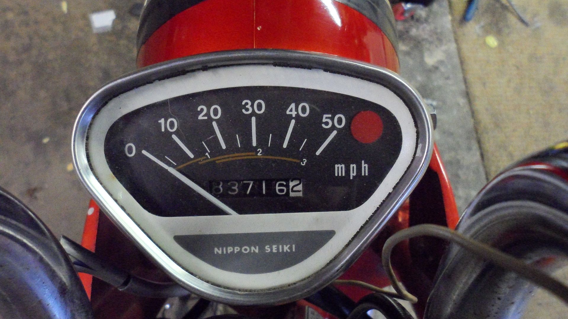

It seems to be in really nice shape for over 40 years old. Looks to have 80,000 miles but im not sure if thats correct. Maybe.
So far got it to 40 mph, if the speedo is accurate. But now its pouring rain so I cant ride it anymore.

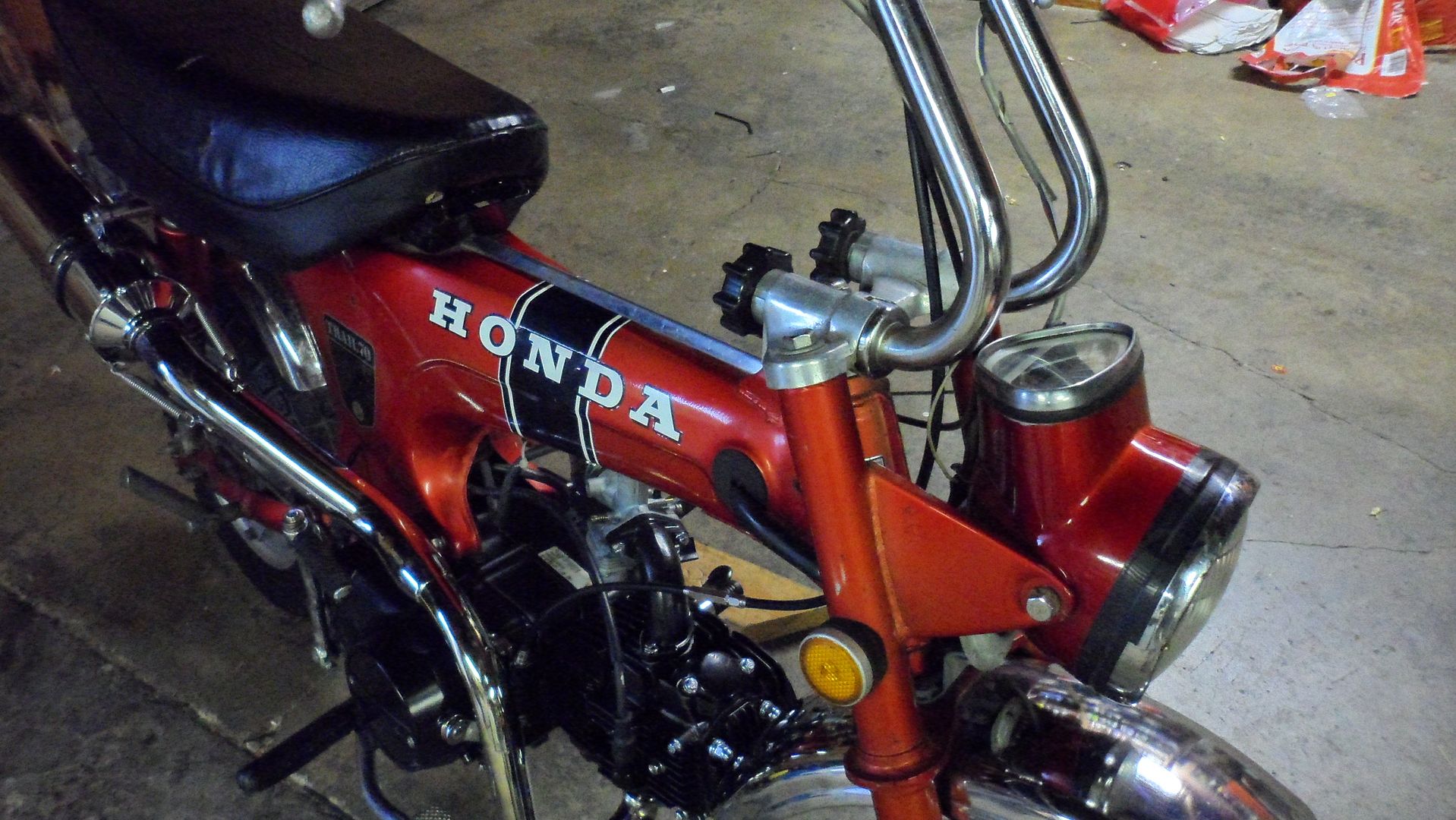

Has brake light, headlight uses 6v battery system. I see no signs of ever having turn signals. Hope that wont be a problem I dont think so as I could use hand signals. No mirror either. I feel totally safe on the road with other cars but so far its only on one lane roads in town.
Wants to pull a wheelie taking off.

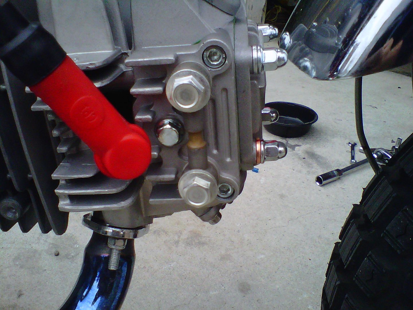

Whatever reason has a really short plug in it, compared to mine. I put my plug in off my dirtbike and it works so im going to use that. I dont know if they had changed the plug or what.
I was told its a brand new engine I think the kid who owned it put the engine in and had to pay $500 in fees to register it then needed money to buy a car so thats how we got it.
Has some cool features, has holes in the frame for a carry handle or lifting handle. But I can see it never came with one, the holes have rubber plugs. The gas cap can be turned off not to allow air to flow out. And the bars and fold to the side so I think you can haul it in your car trunk
If you had the semi auto model you can also run the clutch line into the rear drum brake through its own mounts. Or like mine is another mount so you can use a foot pedal for the brake. And lever for clutch
I really like it and want to bomb all around town on it. Its super fun and with the larger engine about as fast as my 50cc ruckus. Im sure its not geared like a bigger bike would be but it seems to handle the streets just fine. I bet everyone thinks its illegal until they see the plate
I got insurance on it, only $32 per year
Since my dad doesnt have a motorcycle license guess who gets to drive it on the streets :awesome:

I know most of the number vibrate when riding unless the one next to the white is not like usual odometers
just havent really watched it yet when driving
did you see the shift thing on the speedo for the original 3 speed 70
you think in 3rd you could hit 50 mph?

yeah i noticed the gear ranges. i doubt the old engine would have done 50. but maybe someone around here could shed some light on that.

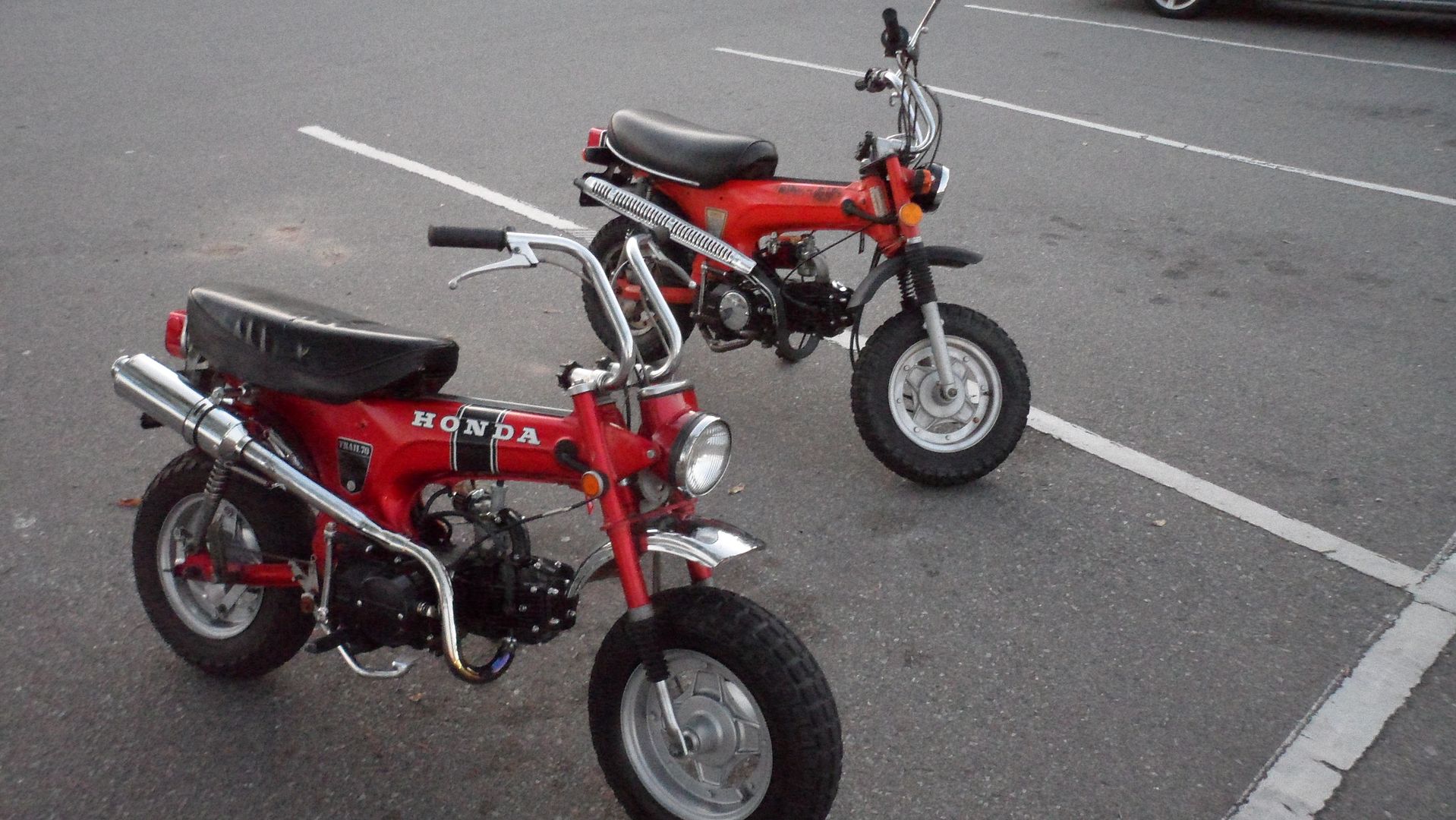

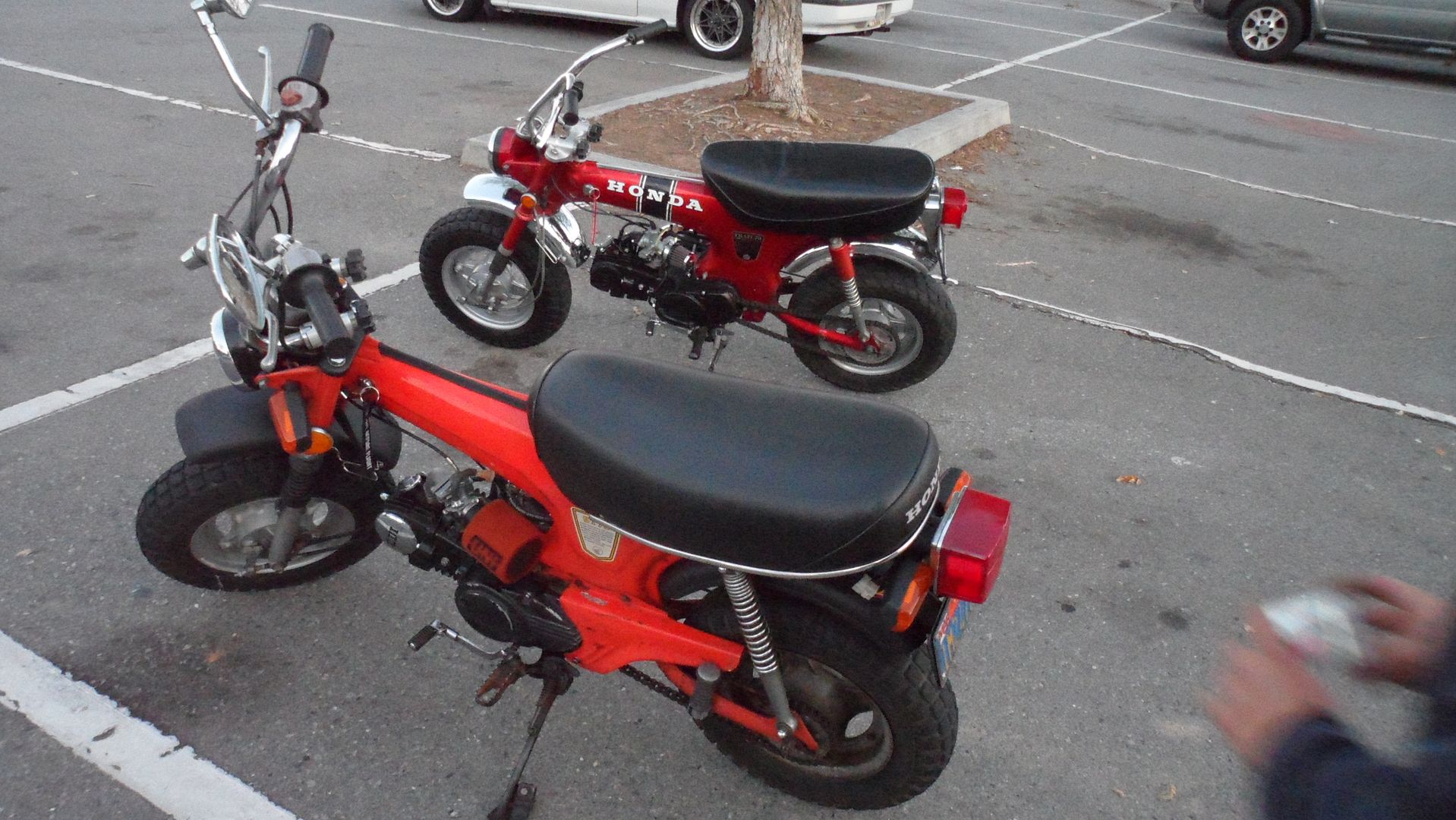

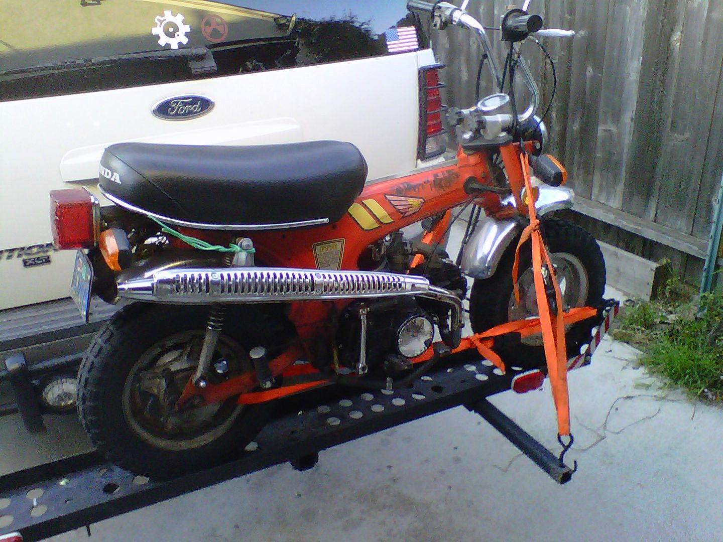

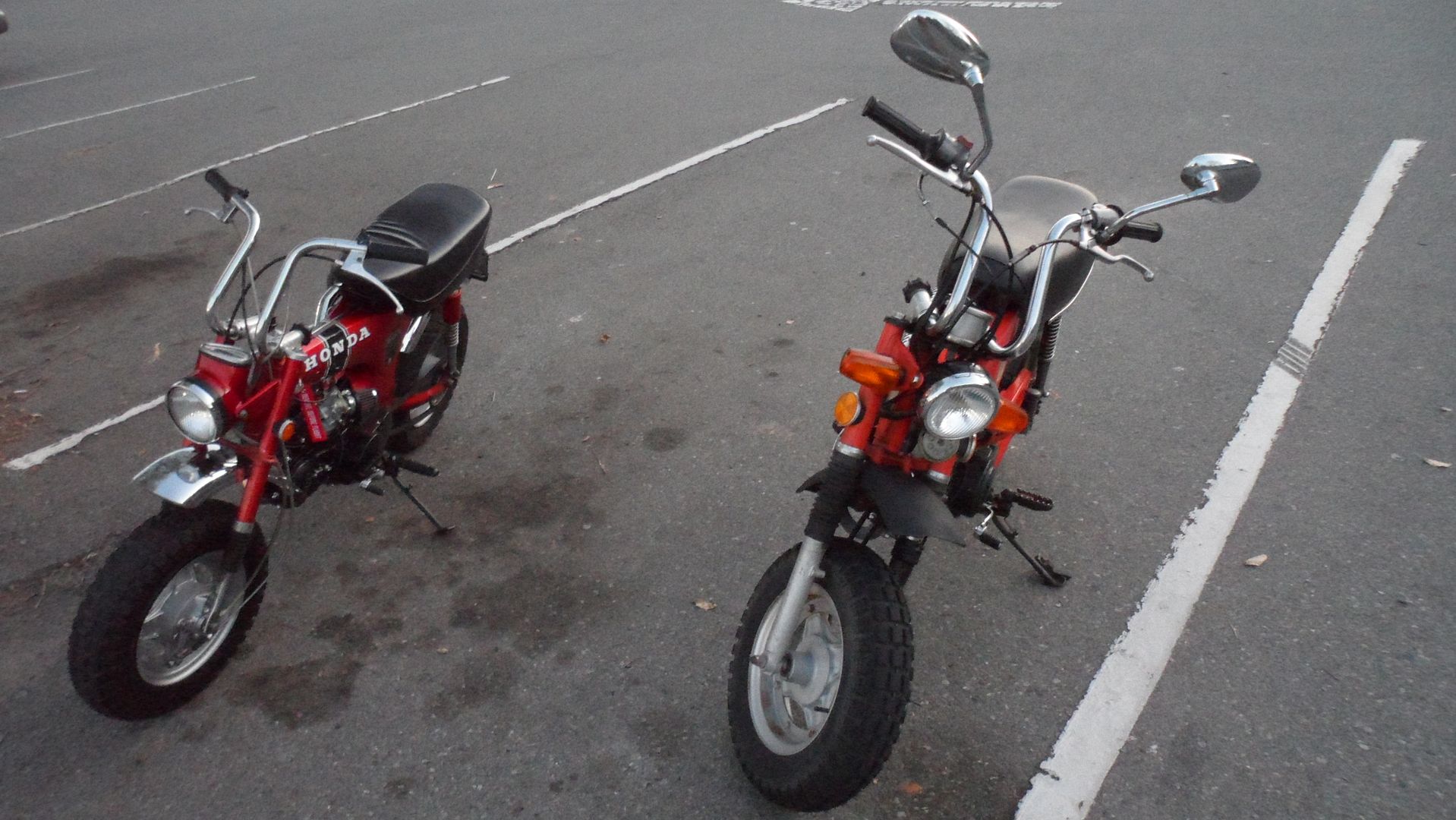

brought another one home today
but its my friends
little rougher then mine, only 3000 miles and 7 years newer
so thats why it has signals and mirrors
same lifan 125 engine too, but the guy geared it for more top speed so im curious to the gains
now we can gps run both see if it helps much
he is going to clean it up more paint some of the parts black maybe
the new harness install wasnt as clean as mine, alot of twisted wires, exposed wires so we soldered them all up and heat shrinked them to keep from shorting out
also his came with old dead battery but $600 cheaper then mine

My friends ended up having a leak in one of the seals, at the flywheel
The gy6/ruckus/zuma flywheel tool works on the lifan engine too which is cool
One tool to rule them all
I had another engine laying around that has tranny problems so we stole the seal from that. Since neither one of us ever took apart a lifan engine we wernt sure how easy it would be to get to that seal. Well its cake to change that one.
The leak has stopped.

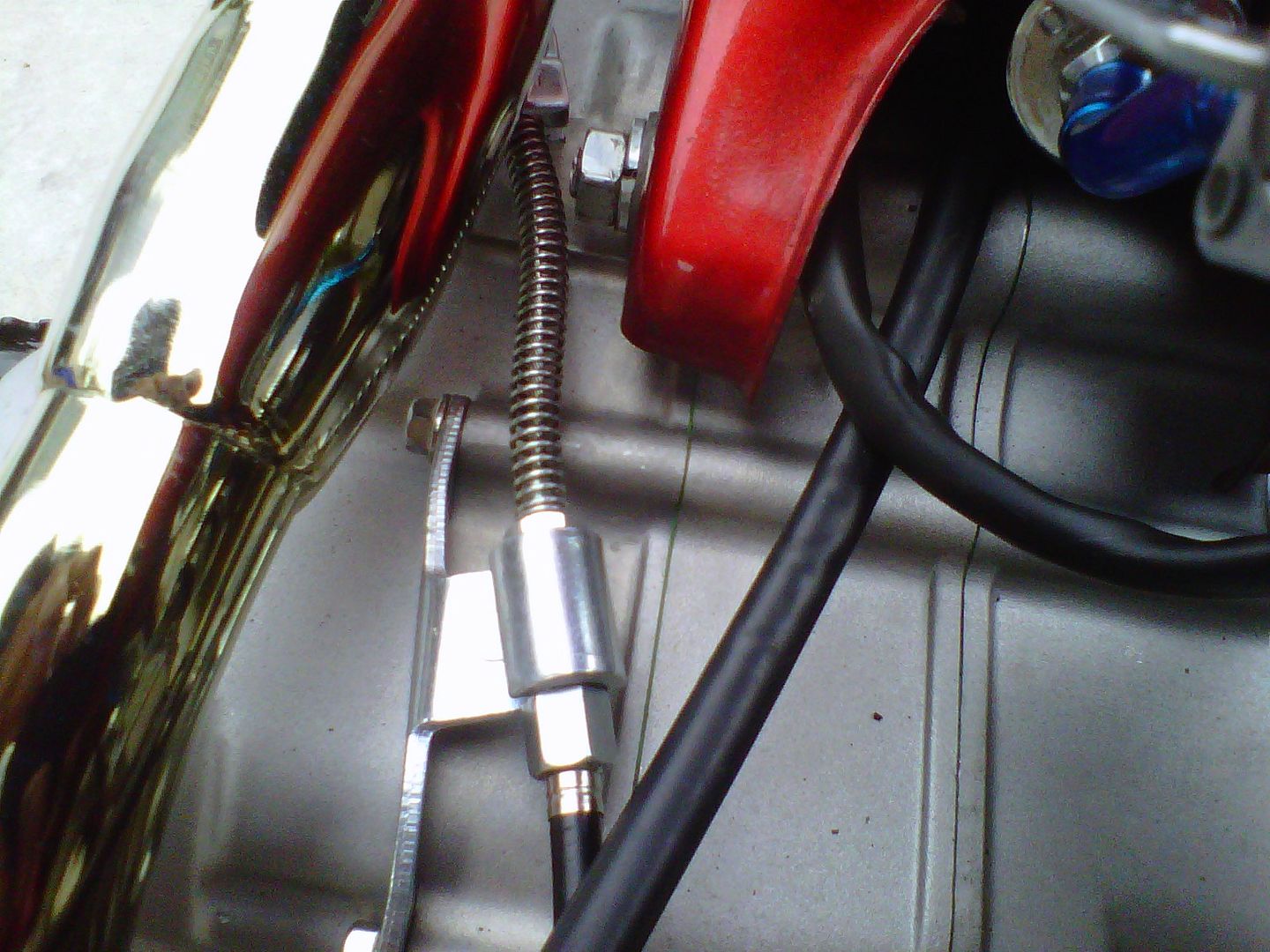

I also broke down yesterday, I had my first official lone ride and about 10 min in I come rolling to a stop. Throttle would not work but it was idling just fine.
Ended up being the hack job of soldering on the throttle cable end, the part that connects to the carb. It just slipped off. Some little nub or stopper that lifts up and down the slide?
So all I had to do was resolder it back on, but really well this time. I think I will start to carry a micro torch and solder just incase mine doesnt hold as its really simple to fix on the road.

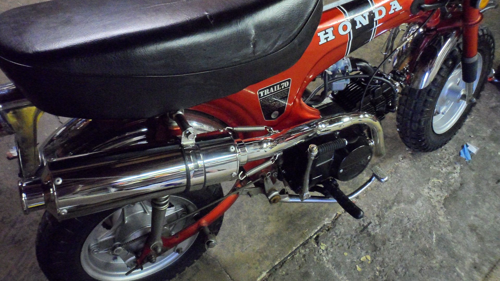

Really cant do anything with the exhaust as that sticks out big time but since the engine isnt stock either I can live with that little change

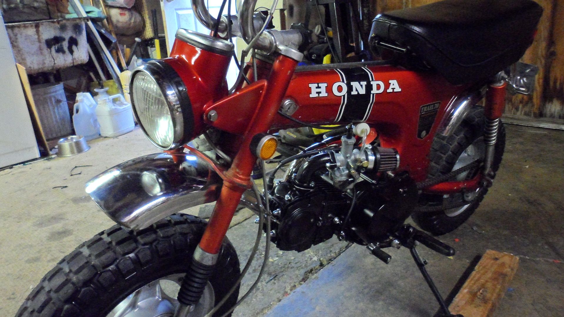

Been slowly adding stock type or cleaning up parts on the bike.
Got new tires looks exactly like stock, got a used chain guard that was missing when I got it from e bay. Got a new seat, and a latch from e bay so it will lock closed.
New headlight ring as mine was taped on, fixed the front brake by adding a recoil spring so the lever springs back, instead of staying half pulled. Put new cover over some wires same type of covers as stock had. Just to keep weather out as they were falling apart.

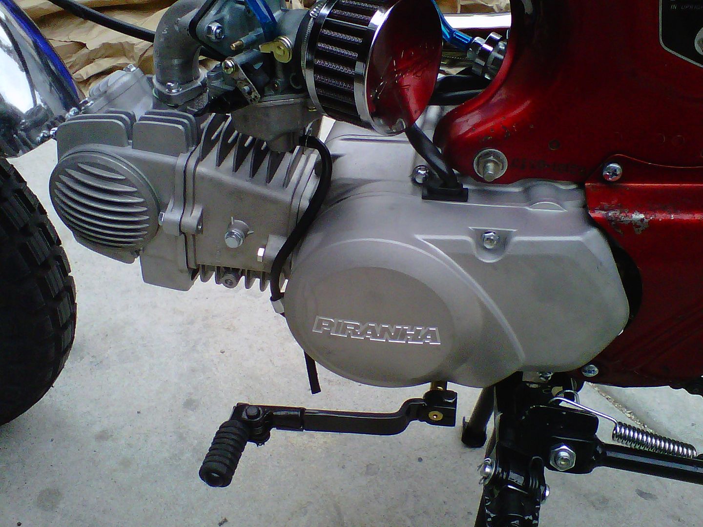

Was running into problems with the engine. If I would down shift from 3rd sometimes it would slip into neutral. Not alot but enough to bother me. So I swapped in the brand new engine from my pitbike. It worked great but I grew tired of having a hard time finding neutral and the clunky shifting.
The type of clutch it uses you must be in neutral to start the engine and cant touch the clutch. So if you stall in traffic you must bend over and try to roll it into neutral then start it.
I ended up buying a new engine that uses a different shift pattern and can be started in any gear. It also shifts like all my old bikes. This one is N, 1, 2, 3, 4 so its really easy to get into neutral rolling to a stop.
Its also a 140cc but I would of taken a 125 just none available at the time. I read this shift pattern is the most strongest or the least issues with slipping out of gears.
Because of this I had a small issue with the new location of the clutch lever on the engine, hitting my exhaust pipe but all you need to do is bend the arm down.
It also came with no way to supply power for my lights so I had to pull the stator plate from the old engine and swap into the new one. Thankfully the flywheel puller that fits honda, zuma, china engines also works with this one.
I also decided to use the new carb it came with, which ended up being a mistake.
I think I spent 4 hours tuning the carbs last night. I ended up going with the carb I had already jetted with the old engine and the intake manifold.

had an issue with my headlight, the key caused the light to go on and off. I think the contacts inside the key are dirty but instead of trying to figure a way to fix that I just ran the low beam directly off the rectifier. It puts out 6v AC. So now the light its really bright only because its a clean source of power
And when I use high beam, still off the key both filaments come on and make a huge light image far away. But at idle with high beam on the lights are really dim until I rev it. But I will just use low beam only all the time and high beam rarely
Also had the speedo bulb burn out the other day so had a new one got that working now. Nice to be able to see speed at night again.

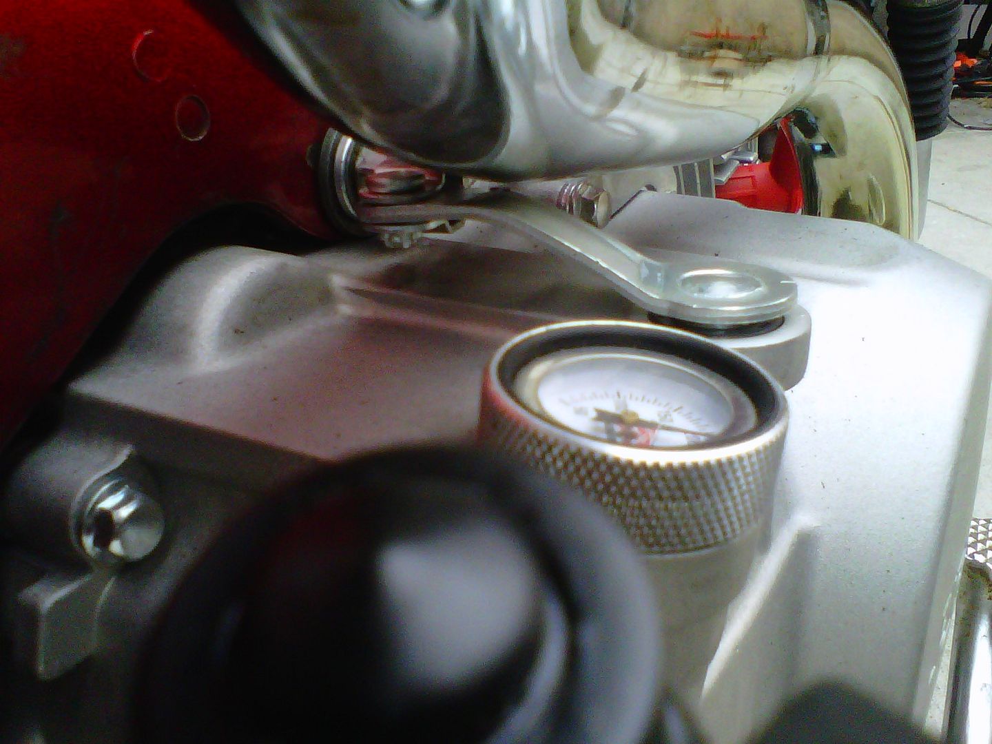

Put on an oil cooler today. Though it would be bolt on but of course had to do some grinding and some head scratching. Also had a set of bad crush washers and caused a leak. Luckily I had another used set that worked fine. Could of got one for cheap but it uses smaller lines and has to mount from the top, so I would have to make a bracket. This one was alot more but came with a bracket that mounts on the intake and uses larger lines I guess to move more oil.
So far after 2 runs its only cooling -25F
I was hoping for more. Its also very ugly and large. At least I will feel safer going full speed now, as long as the cooler holds up. Still need more miles on it before im assured all the lines etc. will hold up.
