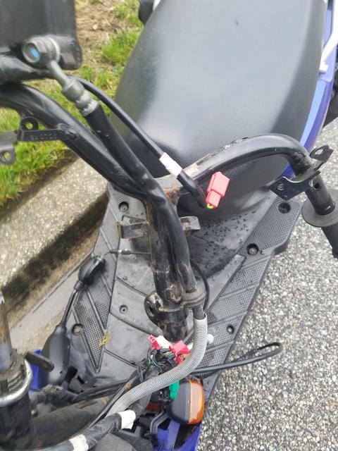

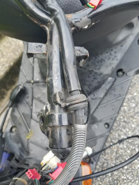

I know this is an old thread, but wondering if anyone has a suggestion related to this. I'm replacing my damaged handlebars, but not sure how to remove the brake line from the built in clip. The only thing I can think of is to remove the hose from the mastery cylinder, then slide it out of the grommet, then flatten the grommet to pull it out. But I'm hoping that someone will have a better suggestion.
