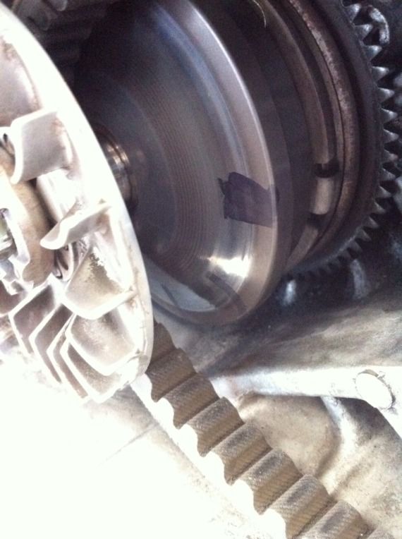

I had to go thicker so it sat further down

You should have a lot more belt travel than that based on your sharpie marks.
I would be more concerned with the engine stalls you're experiencing. Any idea what running temps are? I would check for air leaks if I were you.

The thicker shim is preventing the variator from closing all the way, and that's why the belt isn't riding all the way up (and your top speed isn't as high as it could be).
You really shouldn't need a shim to get the belt all the way down - the belt itself should force the variator apart. Shims are really for aligning the belt - something I was advised not to bother with when I was a newbie (as opposed to a guy who's broken enough stuff to have learned a little :) ). But then you don't know about the parentage of your variator, so all bets are off. I have an Athena variator, and it's a known commodity.

If you use vario specific shims, you will not have any vario travel issues. Maybe Grav can shed some light on the type of shims he used. If the shims have a larger diameter than the boss, I can see where you may have movement issues.
With a peaky pipe like the pro rep, you need to make sure you are taking off in the lowest setting possible. If not, your bike will begin to shift too soon and you will slowly bog down the road until your revs get up to where the pipe makes power.

Dumbass alert!! The fuel filter I was using wasn't allowing enough fuel into to it and because I didn't har it straight up and down it was not filling itself. Revving as high as the pro rep allowed me was sucking so much URL the older could not keep up and, well you get the idea. New fuel line installed.
To be 100% honest with you I just took a washer from my "stash" that was slightly thicker then two of the OEM washers and drilled it out to slip onto the shaft. Tisk tiskI know but it works great.
For SOME reason my torque driver wasn't opening up as far as it should have. All I did was take the bell off, open it up a buch of times by hand then forced it open a little more with a big flathead screwdriver, re-installed it and good to go.
I currently have 5g rollers in and from 0-20Kmh it revs at about 9600-9700 WOT then drops to 8500 and I run at about 80kmh flat at 9000RPM. IM ASSUMING. I can go faster if I tune so that I'm always at 9400-9500RPM I will have better top speed but I'm worried about over-revving from 0-20.

If the diameter of the shim is wrong then you really are fooling around where no man should go. Or woman.
It's the thickness of the shims that one changes, and as you can imagine this way more subtle than shoving in any old washer. Stage6 sells a box of variator shims. I forget where I bought mine, but that's what you want.
