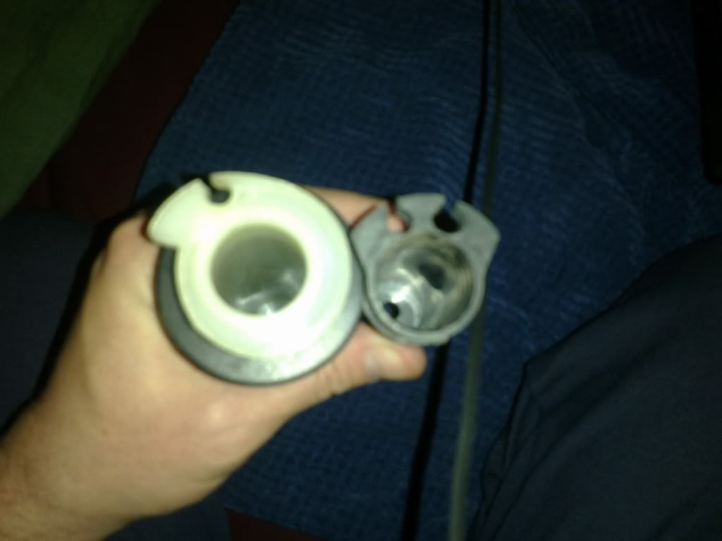

This isn't brain surgery, but Nifty50 suggested I post these pix in case they're helpful. The throttle cable goes in the half of the handlebar "switch" that faces forward (the one with the mirror).
In the other half I cut a roughly 1' section of cable with a cable stop to prevent the throttle from going forward. I'll probably add a right angle tube for the "dead cable" to smooth it out, but it's not 100% necessary. Obviously this cable gets trimmed and tucked into the cable bundle underneath the plastic.
Also, I used bolt cutters to cut the cable "insulation."

While I did put in a right-angle metal tube just for elegance (I had an extra one), I noticed something obvious today: the cable sleeve can't move if you use a cable tie to attach it to the bundle of other cables. Duh.

well there is a much easier way
yes its a bit more expensive but it works great
get the motion pro throttle cable
and a new single cable throttle tube
some thing like this
http://www.denniskirk.com/jsp/product_c ... Id=&mmyId=
then you can get rid of both oe cables and just run the new motion pro cable and you dont have to worry about the throttle turning over on you

the one on the right is the oem throttle tube
you can see the diffrent shape of the tube
ill have to fix the link as thats not what i ordered this is what i ordered
but i just used the tube from it
when i bought it it was on sale and cheaper then the tube alone
