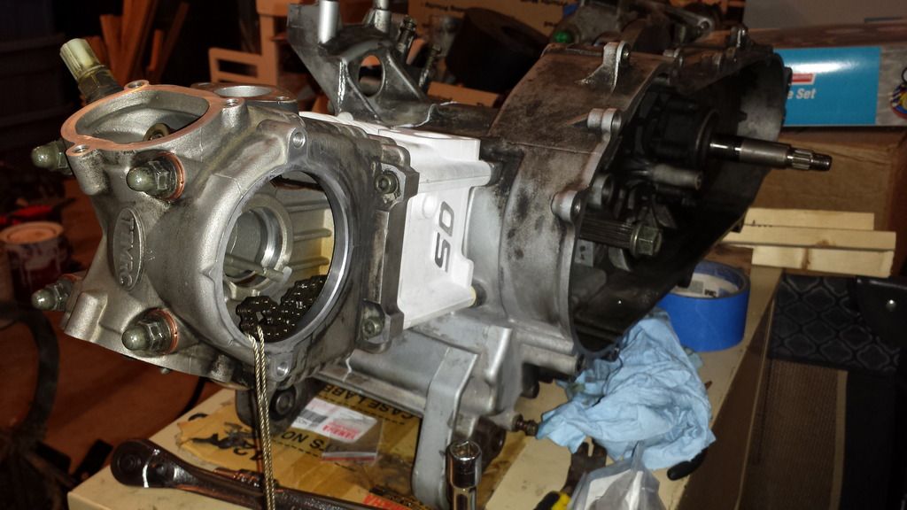

I ordered a new 59mm forged BBK from Chris @ RC scooters that is specifically machined to work with a stroker crank/rod setup. The piston has a low profile deck and the cylinder is also Nikasil plated.
This time for extra precaution I adjusted the cylinder gaskets to give a squish clearance of about 1.3 to 1.4mm. ~1.4mm is a safer clearance which will allow additional room for heat expansion, but not too much clearance as to cause an inefficient fuel burn during the combustion cycle and result in poorer performance and a dirty running engine.
