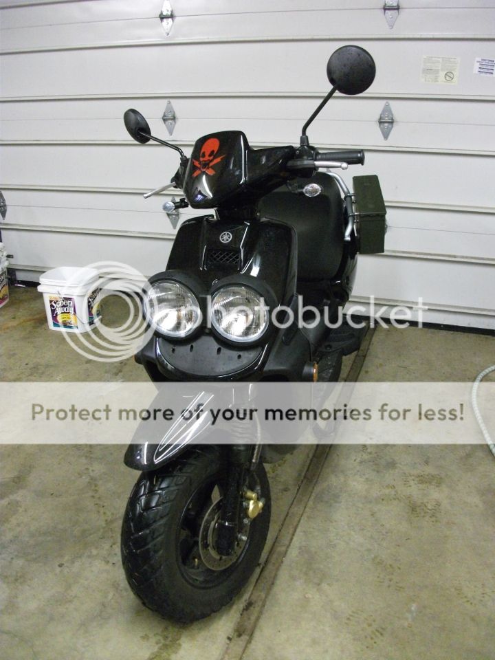

So mine is coming along a bit differently than most. Not chasing top speed. Just hill climbing and getting into the backwoods with gear, because I LOVE using the wrong tool for the job. And I've shown up a few places up in the mountains that had guys out there on big Adventure Touring bikes just shaking their heads in disbelief. "Insane", "Nuts", "Must have a death wish" are a few of the things I've been told. :D
On to the Zuma.
Started as a brand new 2009 I bought last summer with .4 miles on the odo (now has about 3,600).
First thing I did when I got it home was tear it apart and do the throttle mod and dual headlight mod. Never had much use for warranty crap anyway, always end up fixing stuff under warranty myself.
Then the triple brake light mod came. And I trimmed down the extra crap off the back end. Plugged the big hole left by the fender extension with a spent 7.62x54R round.
Put red LEDs behind the gauges. (With a piece of foil tape on the ends of them to get rid of the "hot spot")
Next I decided that I wanted a louder horn. So I stuffed a Wolo Bad Boy air horn up under the cowling. Just barely enough room under the ignition switch for it with a custom bracket. That is powered through a relay, tried it at first with the stock wiring and it blew the Zuma's fuse on the second blast of it.
Being I like to ride off road and also wanted trans venting. I mounted a small computer fan in place of the stock horn (but slightly offset to avoid rain coming in through the vent) this funnels into a hose that runs to a 90 degree elbow epoxied into the front of the CVT cover. There are 3 vent holes I screened in at the top rear of the cover. That is wired to a toggle switch near the key. Seems to work well. Not as good as turning the CVT cover into swiss cheese, but better than sealed.
I also added a 12v power port that is in about the same spot as the 2012 Zuma bag hook to power my GPS.
I have had no battery issues so far with everything running.
Eventually I put some 6.5g Dr. Pulley sliders in to get better climbing abilities. Worked great.
And a Malossi torsion controller.
Fast forward to recently and it got a TP 70cc kit with all the goodies you need to go along with it.
ZTR 1,000rpm torque spring.

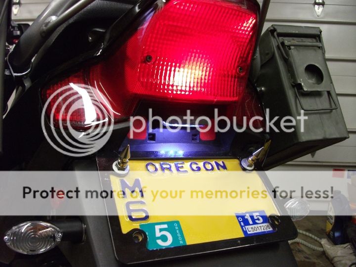

Also found a license plate light at the dealer that has angular lines and such so it fits the lines of the Zuma nicely.
the big square turn signals always bothered me. Seemed like whenever I looked at it my eyes went right to the signals.
So I found some at the Yamaha dealer that were cheap and fit nicely. For the front I just drilled out the hole bigger on the stock brackets and bent the tab down 90 degrees.

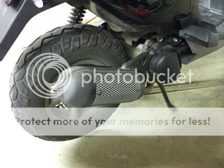

Then I decided to dump the plain old heat shield from the exhaust. Made one out of some steel mesh (this satisfies my Mad Max tendencies, you should see my car. Looks straight off the set of Mad Max.)
Then today something I've been wanting to try out for a long time was finally put together.

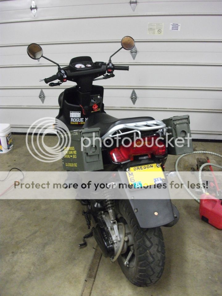

The ammo can side boxes. Fastened with some U-bolts and a foam rubber pad to protect the body on the front lower inside corner. Those will come in handy for hauling a few items on camping trips.
On to a few pics.
Don't really know how much I'll update this. For the time being I have it just how I want it. But I'm sure it'll get some things changed. I want to put a better fan on it by summer. Get a better clutch. Maybe a better variator. You know, the usual. :)

Yeah being mine is on the rack it's a smaller tube/U-bolt. I actually have it resting at the bottom against the body panel with a 1/2" thick foam rubber pad protecting things. Seems solid, at least enough for my use. I figure I'll use them for lighter objects.
I have the u-bolts double nutted which gave me the right amount of spacing as well so the box is right up against it all with washers to provide more surface area. Then on the inside it's washers and lock nuts. So essentially is triple nutted with the last being the locknut. Should stay tight, but I'll keep an eye on it. :)
I might see if I can find some grade 8 bolts to replace the stock ones that hold the rack to the scoot just because as well. Not 100% sure on the quality/strength of the stock bolts.

Good idea. I ended up using Wing nuts on the inside of the box, with the thinking that I could remove the boxes without any tools. Unfortunately, I didnt realize how much I had to torque the bolts down to make sure everything was snug.
Any particular reason why you want a different fuel carrying setup? Ive got a 1.3 Gal can that fits perfectly on my floorboard. Im always looking for more range though.
