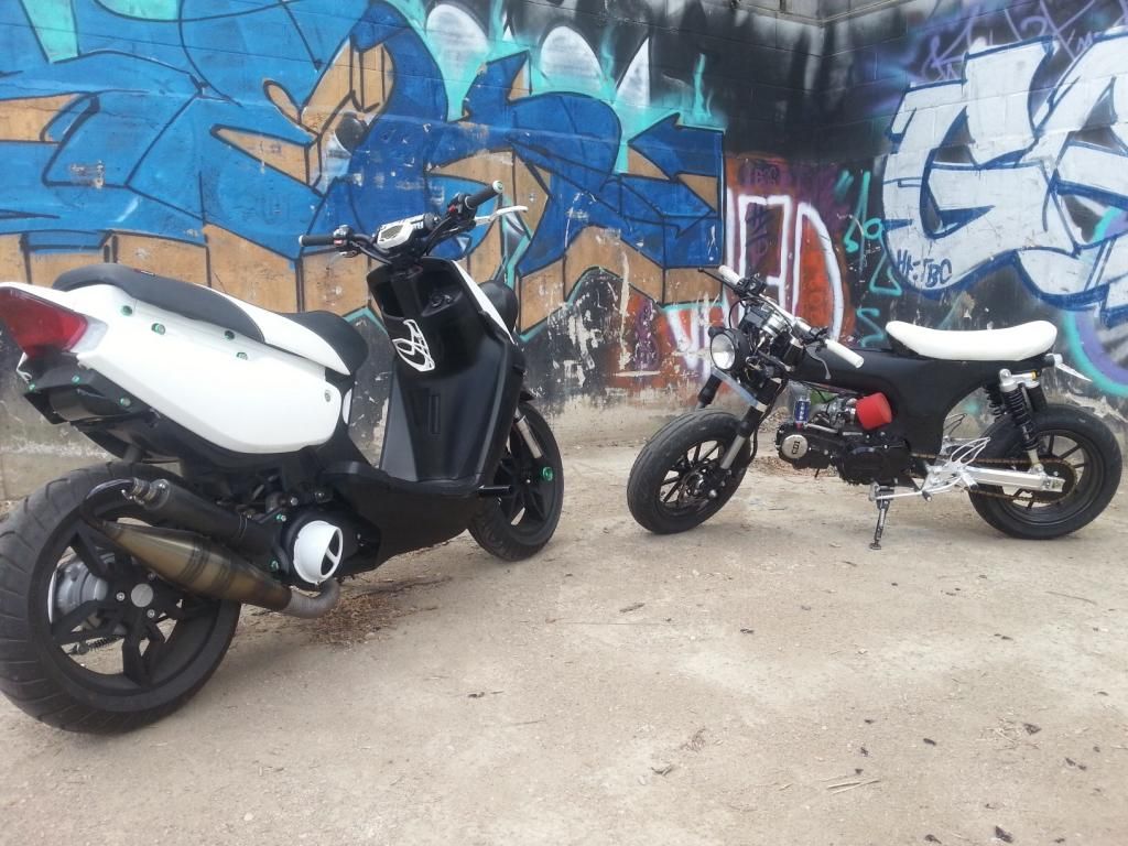

Just a pic of my bugeye and my buddy's sick Honda CT70
