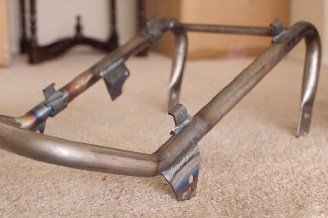

Bought this ruckus frame thanks for the great shipping and packaging! :banger: Powder Coating it black (not sure if I'm going flat or gloss or that rough bed liner coat.

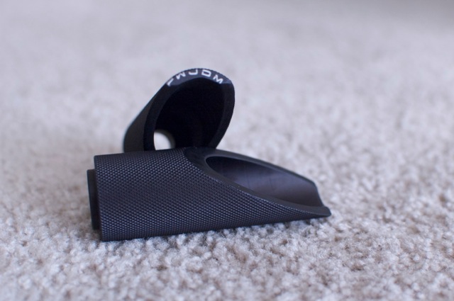

PWDJDM Pegs

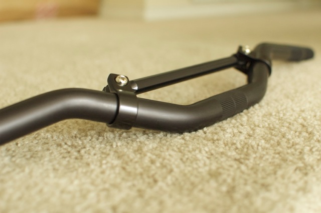

BGM 22.2mm Handlebar Matte Black From DROWSPORTS

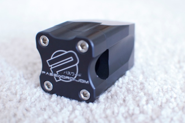

PWDJDM Stem

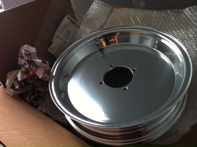

Daytona front rim 12 x 2.75 from Higrade on totalruckus.com. Great seller by the way.

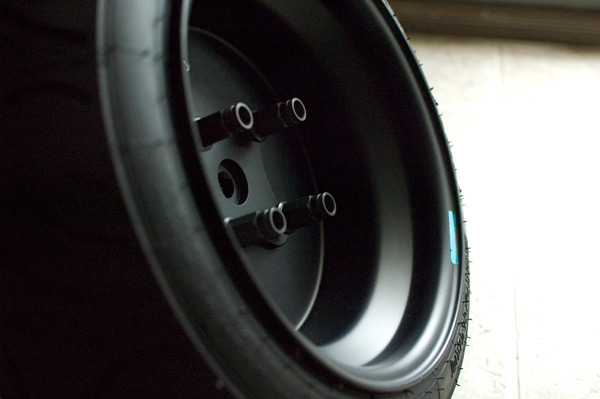

PC'ing it flat black to match my solid 12x7 rear!

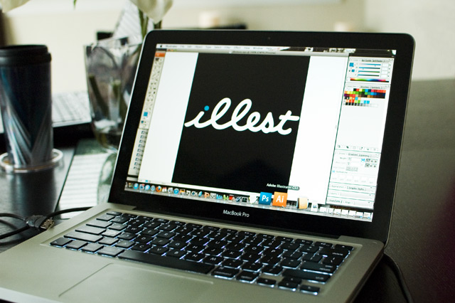

fatlace/illest doesn't carry a sticker with the subtle teal blue that i want. sooooo i want to make my own vinyl on my vinyl cutter.
this was supposed to be going on atr carbon fiber bb of my murdered out ruckus with other teal highlights that I won't be giving away just yet... I ended up going with something more subtle that I'll show off later in the thread

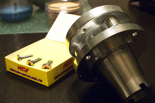

latest arrival in my splurge for all the parts i need... division front wheel hub and titanium rotor bolts from swaptchicago.com. sick quality! The plan is to powder coat or ceramic coat the hub black. I need to make some calls and see who can do what. Any opinions or expertise when it comes to what can be powder coated or what should be powder coated and what shouldn't be?

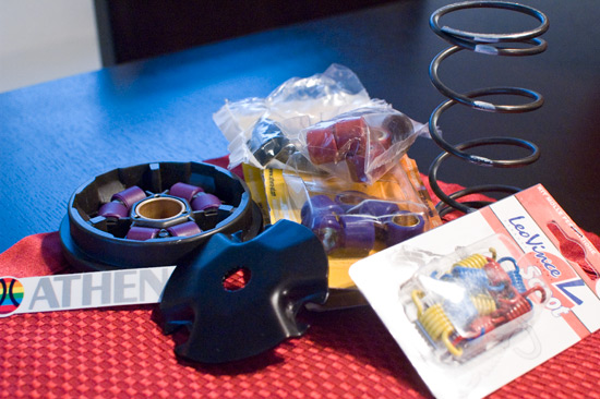

racking up parts!
in the picture:
athena variator
white contra spring
leo clutch springs for the 08 107mm stock zuma clutch
3.5, 4.4, 5.0 rollers
however
i am not using the leo clutch springs or the white contra. I'm running a malossi yellow contra, torsion controller, and blue malossi springs (currently engaging at 6k rpms with my arrow extreme (just being used for mockups and to get the bike running) and 5g rollers all the way around. I have a derestricted c16 that I'm currently having a custom mount made for, by theruck1, so that my yasuni can fit with my 7 inch wide rear wheel.

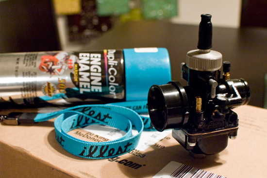

19mm dellorto carb racing black edition. easy to change out the goodies! screw top for the win!
illest teal lanyard. I called up illest and they wouldn't sell me one because its in-store only for these limited edition lanyards. soooo I had to buy it off someone else.

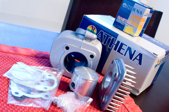

racking up parts x3!
athena 70cc bbk

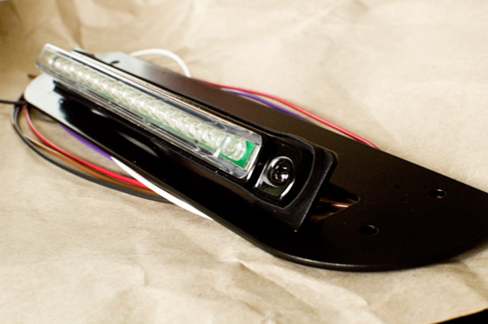

racking up parts x4! :banger:
turtlehead led taillight! fab on this is great!

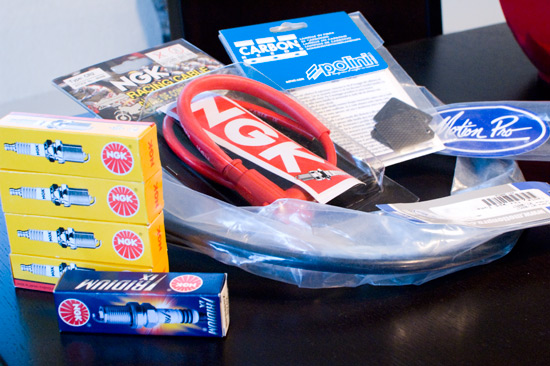

motion pro cable so I can run my zuma controls and the new dellorto 19mm racing carb until I get my custom longer cable for my stretch on my ruckus
polini carbon fiber reeds. two different stiffnesses.
ngk spark plug wire
bpr8hs ngk tuning breaking in plugs. team calamari threw in the iridium but I'm running bpr8hs with the athena setup

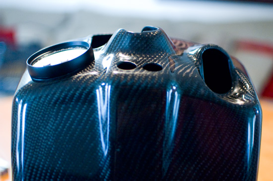

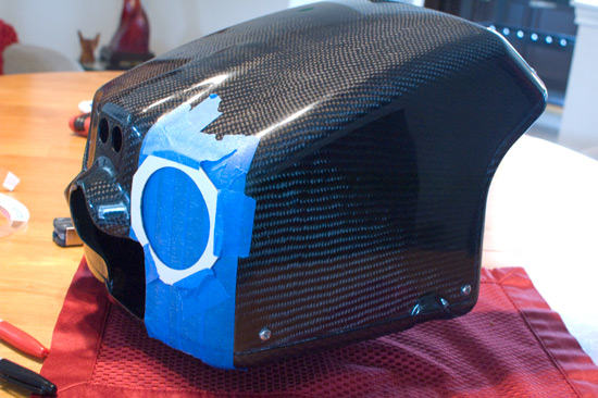

just tucked my balls and put a fat hole in my carbon fiber battery box! came out great!
this hole, my friends, is not for your average ruckus speedo.

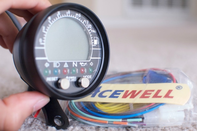

its for my acewell 2853 (black version!!!) speedo, tach, fuel gauge, blinker combo.. mmmm mmm mmmmm.

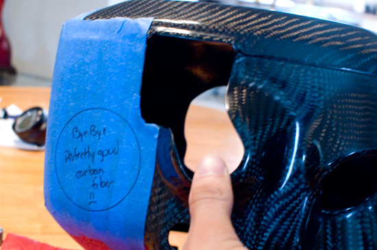

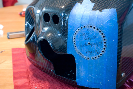

taped and templated. pretty convenient that the gauge had this piece of cardboard in the box it came with. i taped up the box and outlined on the tape instead of scoring with a knife on the battery box like I saw in one diy. the tape serves as protection in case I slip (which i did) and as a writing surface.

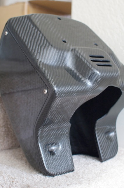

ready to go! bye bye carbon fiber
drilled! used that one bad butt tear drop looking bit with my dremel tool to cut out between the holes and then used the sanding bit to make a clean edge. test fit, sand, test fit, sand, test fit, sand. over and over till it fit snug.
final product!

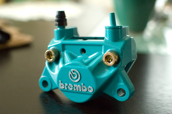

painted and diamond clear coated brembo. sexxxxyyyyy.
rear solid 7incher, with buddy club open lugs holding everything in place 8) the teal vinyl strip in the bottom right corner is the test strip for my .25in teal vinyl strips that will be going around the front solid and rear solid rims.

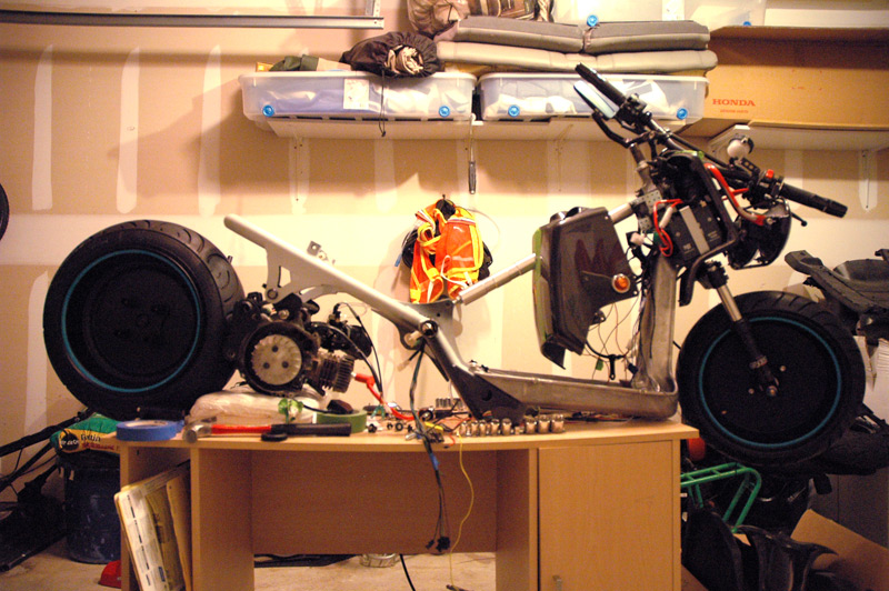

rear mockup, smooth welds engine mounts, center shock mount, and primed from rucksters. big thanks to tony for getting this done and out to me. everything here will be painted/powder coated flat black. you can see the triangle mounts to hold the zuma engine as well as a modified hanger from the zuma to fit the triangle mounts. the engine will be stretched a good foot back from the normal ruckus engine mounts.

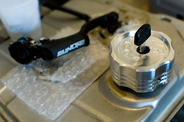

RAT KOUBOU gas cap cover! :shock: I love how the height of this thing is not the standard height of most gas cap covers. I'll be custom painting it. Not exactly sure how yet, but final paint scheme will happen in the next 3-4 weeks for the entire frame of the bike. By the way, big thanks to Yutaka out in Japan for making this truncation super easy! By the way that's my SUNLINE rear brake in the background!

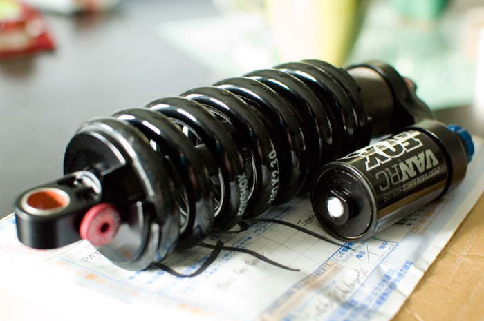

FOX Van RC Shock! Big thanks to Tony and the whole Rucksters team for making Fox hate them and not me! Tony sent the Fox shock from his Smokin Aces bike back to Fox to have it cleaned up, fixed up, refurbished, etc. and they gave him the run around for months... so happy to finally get this in! For reference, its 7.5 x 2.3 and will be center mounted! yuhhheeeehhh! Plus got a couple of free rucksters shirts out of the deal! :banger:

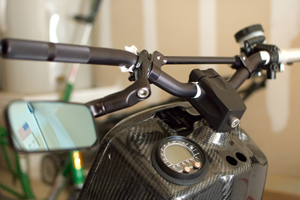

and finally some initial front end mockup
