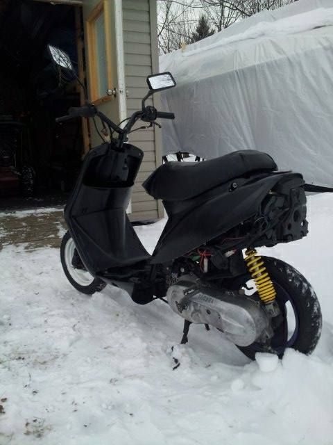

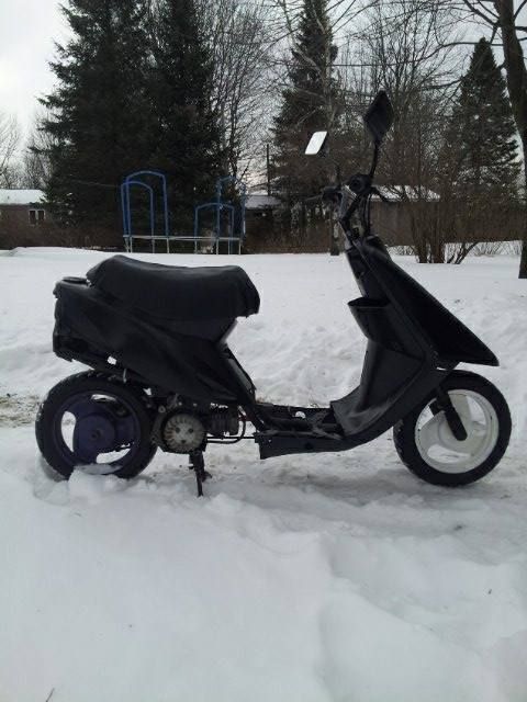

- Selling the street legal bugeye, pictured above. It will be rebuilt with good used stock-ish parts, and my cleanest plastic set.
- Build the extra bugeye frame for track use, and it will be participating in the "stock" category. So stock carb, stock bore, stock gears. It will have an exhaust, most likely a Tecnigas Tek, and my Bopper tires. I have a set of ruined plastics that I will use for it.
- Swapping my parts to the Jog, pictured below. The whole liquid cooled Team is going in there. Along with a few bonuses...

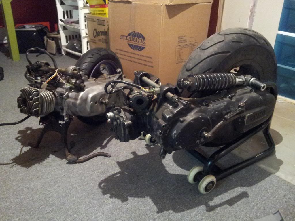

About that Jog... It's a 2T Minarelli horizontal design, the cylinder/crank design is the same as our bugeyes. The CVT cover is different along with the whole rear-end. It's a short case made for tiny wheels, right now it is running a 80-90/10 (3.00" X 10) tire. I might step that up to a 3.75" tire, but I like the look of the skinny tire. I'll be opening up the crankcase a bit to help the cylinder breathe, but nothing massive. The Jog will also have a beater/sleeper look... right now the plastics are all black, and I am thinking about keeping them that way. It has no rear taillights right now so I will grab an european model tail unit, so they will be integrated in the scooter instead of hanging on the rear rack. For now I also plan on rocking the stock steering with the integrated head light and turn signals, until I figure out what to do with headlights if I decide to ditch the stock handlebar. I will also be rocking those huge, mismatched rear mirrors! The monoseat needs some love so I will reupholster it, but I dont know which color or material yet.
More importantly, the Jog is 80-90lbs lighter than the bugeye (120# vs ~200-210#). That, and the rare sight they are, makes for the reasons I am swapping my bugeye for a Jog. I really like the bugeye's handling and overall feel, but I want to have a few rides with the Jog before selling the bugeye to make sure I don't end up regretting the swap lol. But I think I'll have a blast on the Jog. I mostly do city riding and very occasionally long runs. The front drum isn't too much of a worry considering I don't plan on riding much faster than what it could do stock (and stock they are faster than both prebugs and bugeyes!).

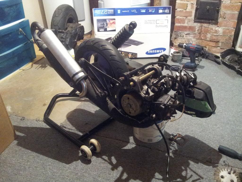

I got the Jog engine today, so I had fun swapping things over to see how they'd look. First picture is the current Bugeye case vs the Jog case. To use my Stage6 stand I had to use a shock and didn't have the stock Jog one so I used my bugeye shock. The Jog will have either a stock shock, or a prebug shock (they are slightly taller and stiffer). Bugeye shocks are too long and stiff for a Jog.
I have no pictures of the track bugeye because it's in pieces. I'll get some when I start building it. It'll look like any other bugeye, except with rugged plastics and missing parts here and there such as the lights.

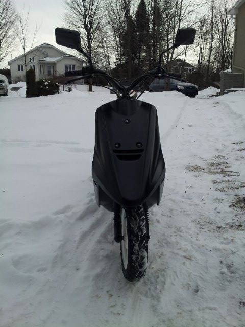

I wanted a sleeper look, but I think I'll be going for something more original that we don't see much around here (in fact I havent seen it on scooters yet, even on Google)... I'll be painting the plastics using chalkboard paint. That way I'll be able to use chalks to draw whatever on it and have fun changing the look of it every now and then. Besides, it's washable lol. I guess I will have to buy a cover for the Jog since it will sleep outside, if it starts raining it will wash itself out. When not chalked up however, the plastics will be matte black.
I have ordered an european style taillight assembly (originally the Jogs have the lights on the tiny rack at the rear) which integrates the taillight into the fairings. I also ordered an OEM-style airbox. It has a larger elbow than the stock bugeye airbox for less restriction, and is better suited to fit on that crankcase.

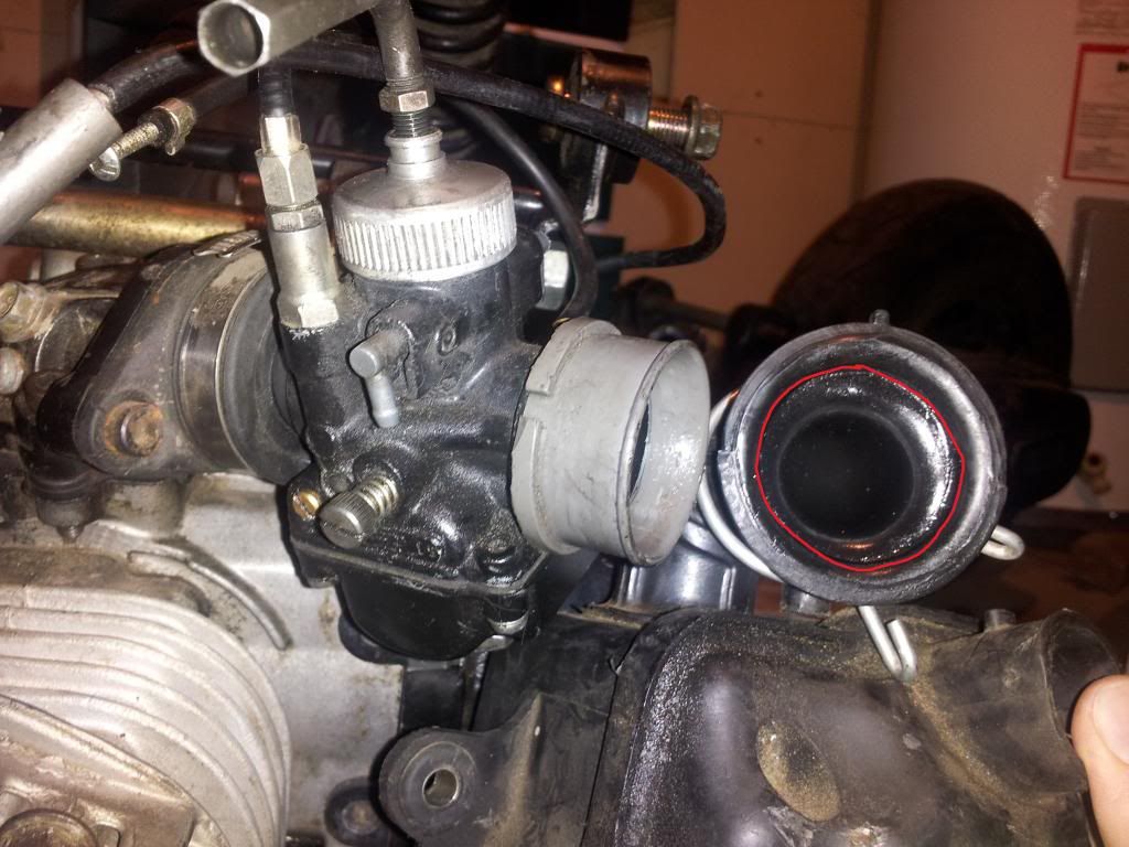

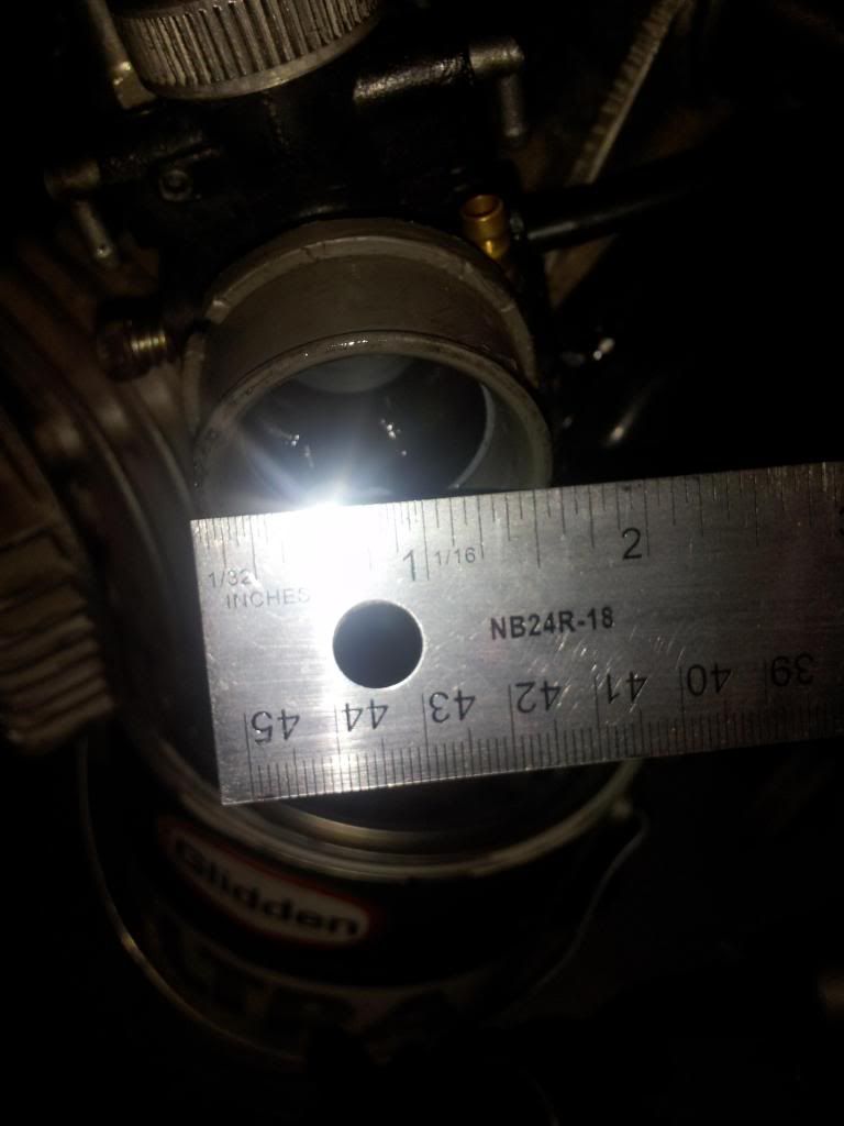

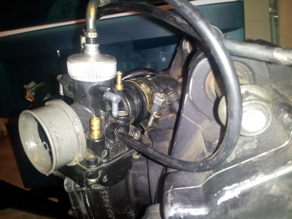

About the intake. I am using the Stage6 intake, but I just tried fitting it on the intake that was originally on the Jog (could be off a bugeye, since it had a bugeye stock carb on it when I got the Jog) and it fits. Very snugly however... putting it in is hard while the intake is on the engine. As Nick said, it needs to be fairly soft. It doesn't need to be brand new, but earlier Bugeyes could be harder to fit.
I'm using the gray plastic bellmouth thing for the airbox. It actually wasnt on this specific carb; it was on my friend's carb, which was the same thing but not for the same scooter. So I'm not sure if the bellmouth is the same.
Anyway, I'll let the pictures talk a bit.
Carb on a stock intake:
Size of the bellmouth is just around 1 5/8":
Picture of the bellmouth vs the airbox elbow. The red circle shows where I needed to use a knife to remove a very thin layer of material so it could fit easier on the bellmouth. I dont think I removed 1/32" worth of stuff. If it's hard to put on, try "filing" the elbow out. Even now it's very hard to put on and remove.

The carb should have a matching narrow groove to lock the carb to the intake.
Use some 2T oil to lube stuff up. Then force it in.

If a Jog is faster, what do they rev to with those small tires? I'm just curious if a crank swap is mandatory with any significant Jog mod or what.
08 Zuma "The Fly" 50: Stage6 Racing Mk.1 (0.7 squish), Athena Race exhaust (S6 Pro), Malossi RHQ crank, Doppler 15/50s, Dellorto 21mm PHBG DS (60/42/90), Top Perf. Vforce3 reed valve, Malossi Multivar w/drive face, Malossi Delta Clutch & Wing bell (Yellow contra, yellow clutch springs on stiffest), Stage 6 R/T forks, Stage6 R/T 4 pot brake, S6 280mm big brake, Aerox 100 rims, S6 CNC'd controls, Brembo master cylinder, Hoca/Bando ignition, naked bars, manual petcock, Pirelli SL26s, dual light mod, re-profiled seat, LED signals, doodads and gizmos (TT Vapor, Harris Project R1 grips, silly stuff) and always running Amsoil Dominator.
Fri Feb 21, 2014 8:10 pm
Joined: Sat Jul 14, 2012 9:14 am
Posts: 981
Post Re: Street '94 Jog (MHR Team 70cc LC) + stock Track Bugeye
They should be revving similar to a regular bugeye. The difference is in the gear ratio. "Wet" weight is spec'ed at 143lbs according to the service manual, including full oil and fuel tanks. Not only do they accelerate a bit faster than a stock Bugeye (dont know about the prebugs), they also have a slightly higher top speed (2-3mph more if I remember).
My friend had a Jog for a long time, and he can't stress enough how much he LOVES the gearing on a stock Jog. He used to stunt the hell out of it... before selling it, then buying it back, then turning it into a dragster. lol.
The factory rear tire is a 80/90-10 (which is what I have). Primary ratio is 3.692 (48/13), secondary ratio is 3.455 (38/11). Variator and rear pulley seems identical between a bugeye and this (I'm thinking Jogs, prebugs and bugeyes all had the same CVT components); however, the center-to-center measurements between the crankshaft and the primary gears is longer on the Jog, but I think this has no effect on the transmission ratio.
I dont know how to do the maths to find out the RPM/speed thing. If someone knows, I'd be interested to find out how much I should be able to get @ 10K and 11K RPM :)
I cant wait to see how it pulls... might have some taming to do :whip:
