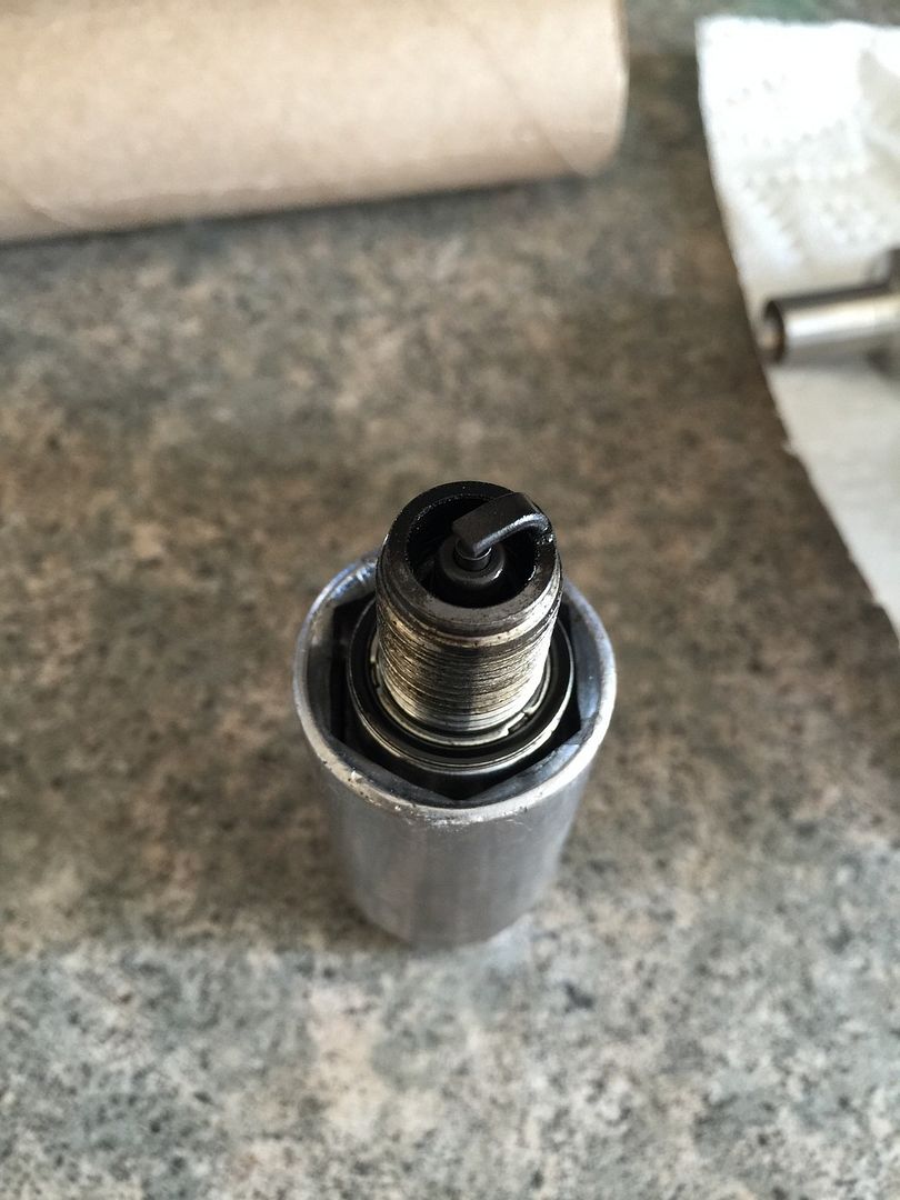

heres a little video of what its been doing. changing jets does nothing. so now im leaning towards spark plug/ coil or wiring.
pulled the plug. lookin MINT!! :butt:

That plug is slobbered.

SLOBBERED

Whoa, mega-rich! Any chance your choke is stuck on or something? What jets have you tried?

the plug was bad. i replaced it and now shes running way good. my jetting still needs some work. but my plug is a nice light caramel.
slow is at a 36, i might try my 34 or 32- cant remember what it was
main is at a 90
needle clip is at the lowest setting.

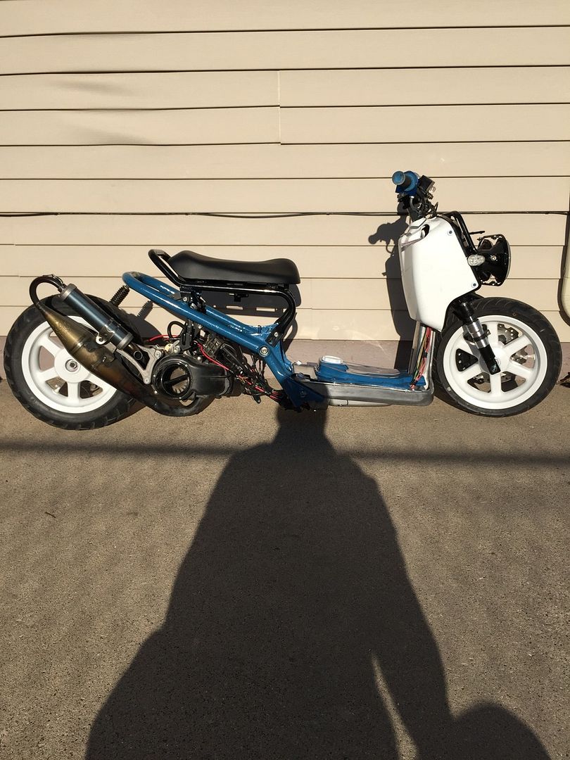

blue air cooled ruckus is running like a dream!
