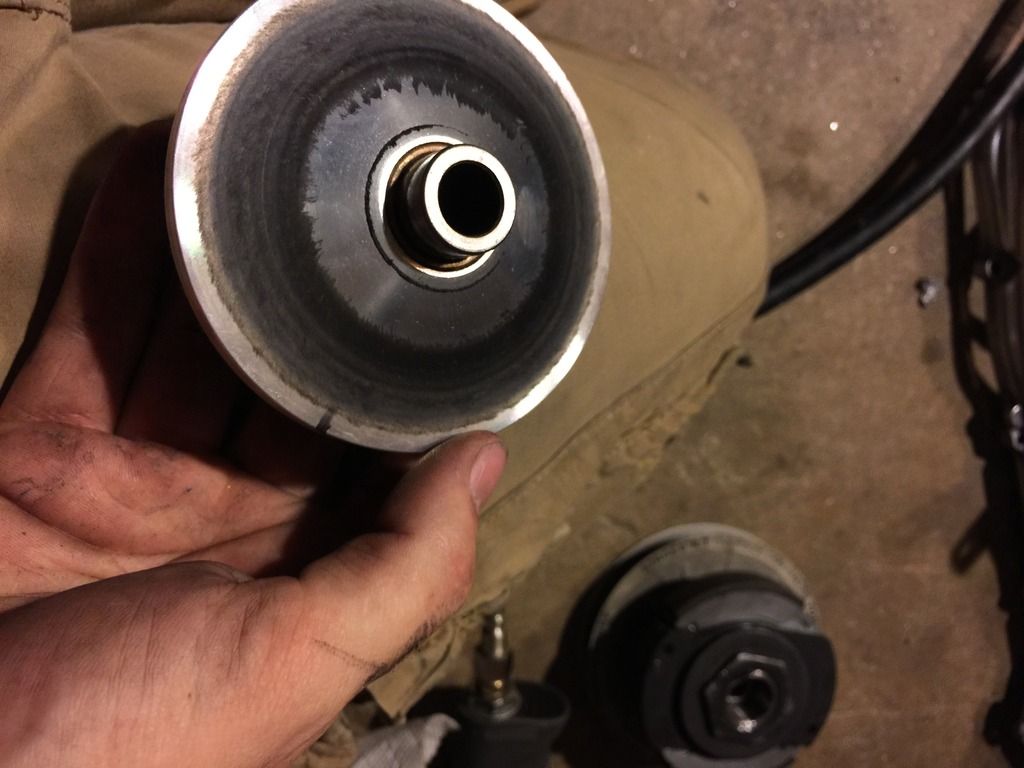

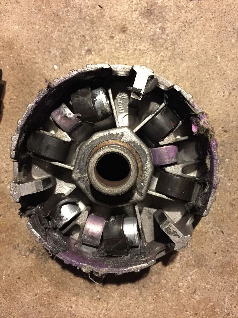

So I believe do to running the wrong contra, koso 2k for dio, and melting the weights I think I ruined my variator. The bike doesn't have the same launch as it did. Even when I went back to the contra I was running previously, stage6 medium . My launch is horrible and I can't even reach my powerband. I'm using the polini 9 roller with a 6 2g and 3 3g combo. I was doing rolling burn outs with this combo a week ago but I would lose my high rpm due to the medium contra. I could sit on bike and do a burnout. Now it won't do it at all. I ran a 12.5 at 52 in the 1/8th mile last night. That's horrible.
First two pictures are right after I pulled the variator on Wednesday 9/2
Plastic casings fused to the ramps. Having a very tough time getting it all out.

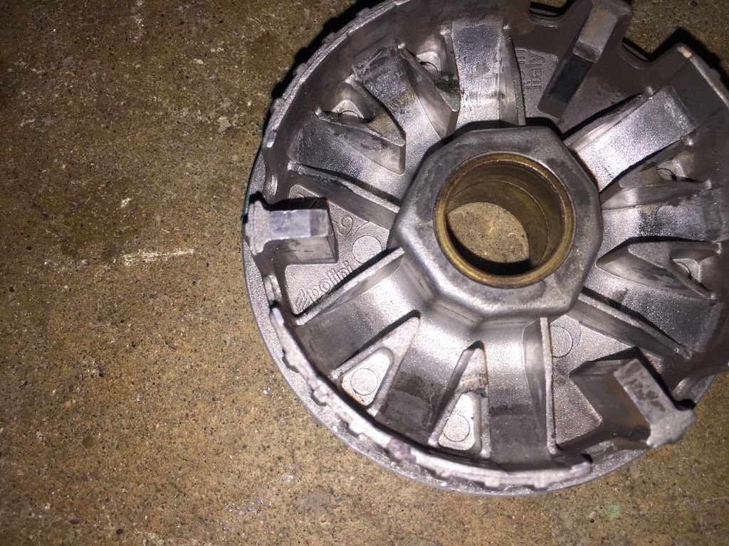

This was today 9/5
Image[/URL
[URL=http://s1142.photobucket.com/user/Alex_Fri7z/media/Mobile%20Uploads/D29E03C5-4BF0-4371-9147-6D9AC746D4ED_zpsq39xcazb.jpg.html]Image
Some of the rollers have gouge marks so there is some resistance... What do you guys think? Has anyone done sanding to the ramps to save them? Otherwise I'm looking at the stage6 rt variator.. Help me out..

looks like you have a cooling issue if those rollers were the correct size
what brand were they?
do you vent the cvt cover at all
I sandblast my variator pulley faces once in a while when my belt starts to squeak alot
that will take away all that melted belt very easy and deglaze the surface at the same time
for the ramps maybe a dremmel with the tiny wire brush attachment
give it a good scrubbing, it wont take away any metal but clean it and smooth it a little
and then you can decide if you can save it
for your performance losses
did you compression test the engine, maybe its just wore out already from all the hard use

I dont see how a contra melts rollers
heat melts rollers, even though your cover is vented, it may not be enough
or your not moving enough to blow air past everything when doing burnouts stuff like that

I have to agree with mike.... There is no way a contra spring would create enough heat to melt rollers. Actually a contra spring creates next to no heat in the Cvt system. Does your fixed half of the variator have cooling fins, or is it one of them smooth ones. With that said has anyone ever seen melted rollers? I know that variator doesn't have the best reviews. With the amount of skin you have in that ride why aren't you running an overrange?

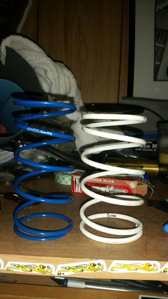

Mina right Honda left

im guessing the 3 and 2 gram rollers is whats causing you to stay at 40 mph
thats really light
do you know how stiff the contras are? I know too stiff and it wont open all the way also keeping you at lower top speed
I dont know much about 2 stroke but I know the pipe you use dictates when you make power and you need to choose the correct clutch springs
and I know too stiff of a contra also makes the bike act like the rollers are too light
so if your contra is really stiff (2000 rpm) and you have super light rollers that makes me think you could have top speed issues then
whats your pipe rated at and whats your clutch springs at
ive used differnet contras that could be 1 spring taller, and also ones that were smaller in diameter
both worked but the smaller one got caught up in the clutch arm and jammed it open
but they were sold for the bike i was using
