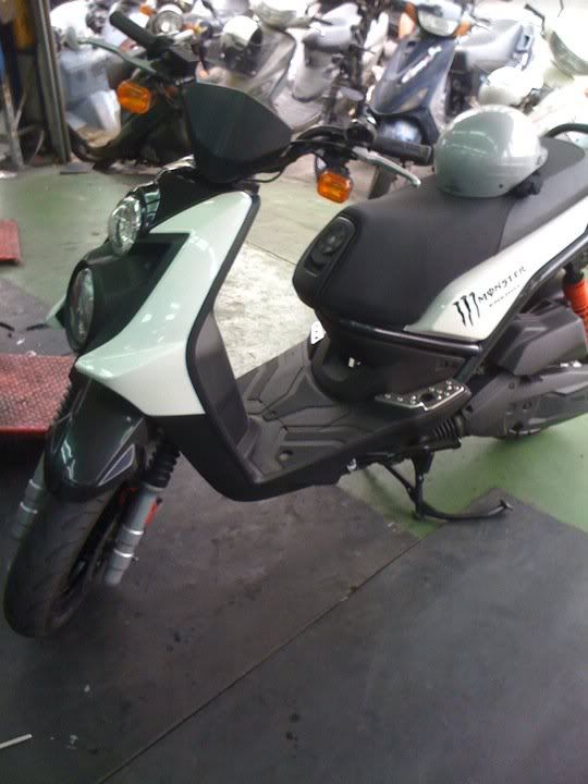

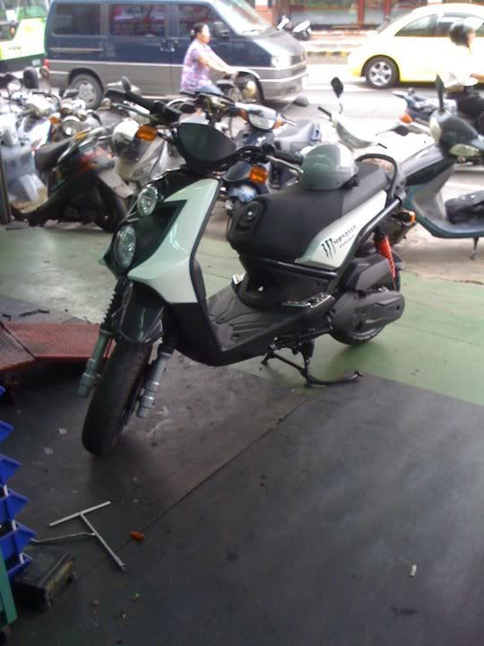

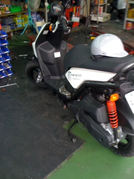

hello fellow bws / zuma 125 fanatics.

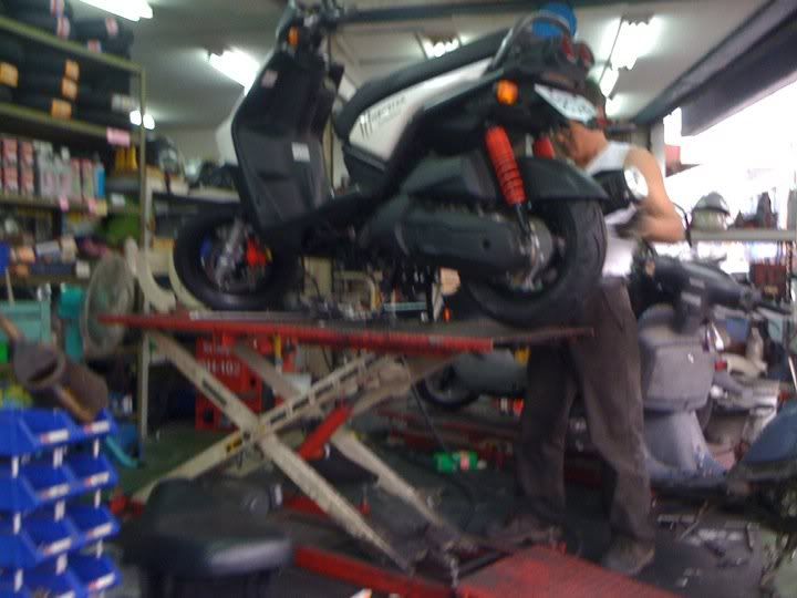

some of you have known, i picked up a white 08 bws 125 this past weekend. this will be my test mule for some of the items i will be introducing later on.
it was a last minute purchase and i rushed down to the scooter shop on a friday afternoon.

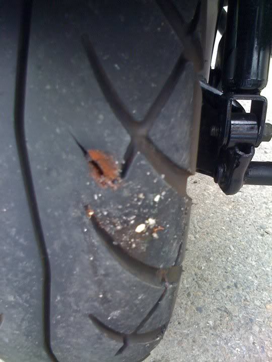

once i left the shop and put a full tank of gas i was on my way. 15 minutes later i got a flat tire :doh: come to find out the tire was repaired and plugged before. riding it like you stole it broke the plug free.
waiting on the side of the road for the truck.
back at the shop getting a new tire.

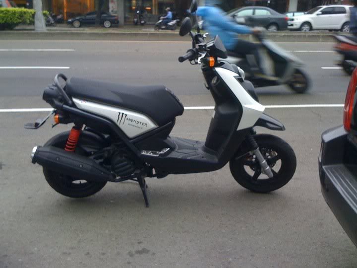

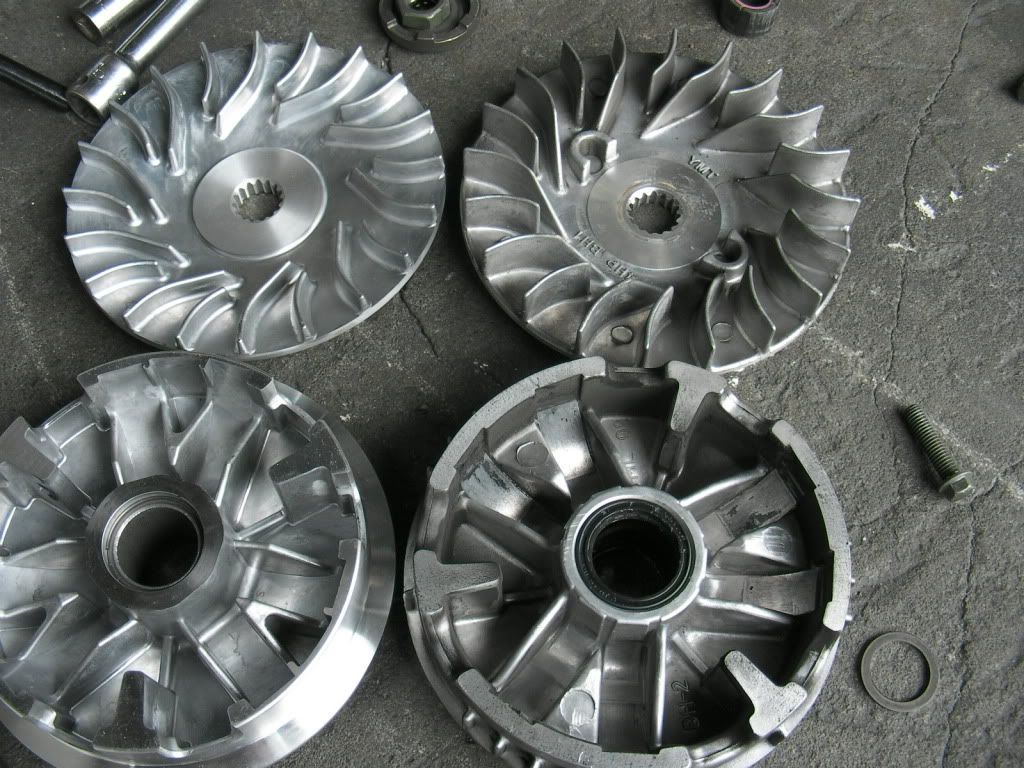

on saturday i installed the forceworks fuel managment unit and a complete cvt upgrade.
tst variator kit with 10 & 11 g rollers
PG 1,500 rpm torque spring
PG heavy duty clutch bell
FRC race clutch
FRC race torque drive
simota re-usable air filter
in the end i was able to raise the top speed from 50 mph to 60 mph (factory speedo varified), this is sitting up. i am 6 feet tall and weight 190lbs. the scooter is a 08 and has 7,000 miles on the odometer. engine is all stock.

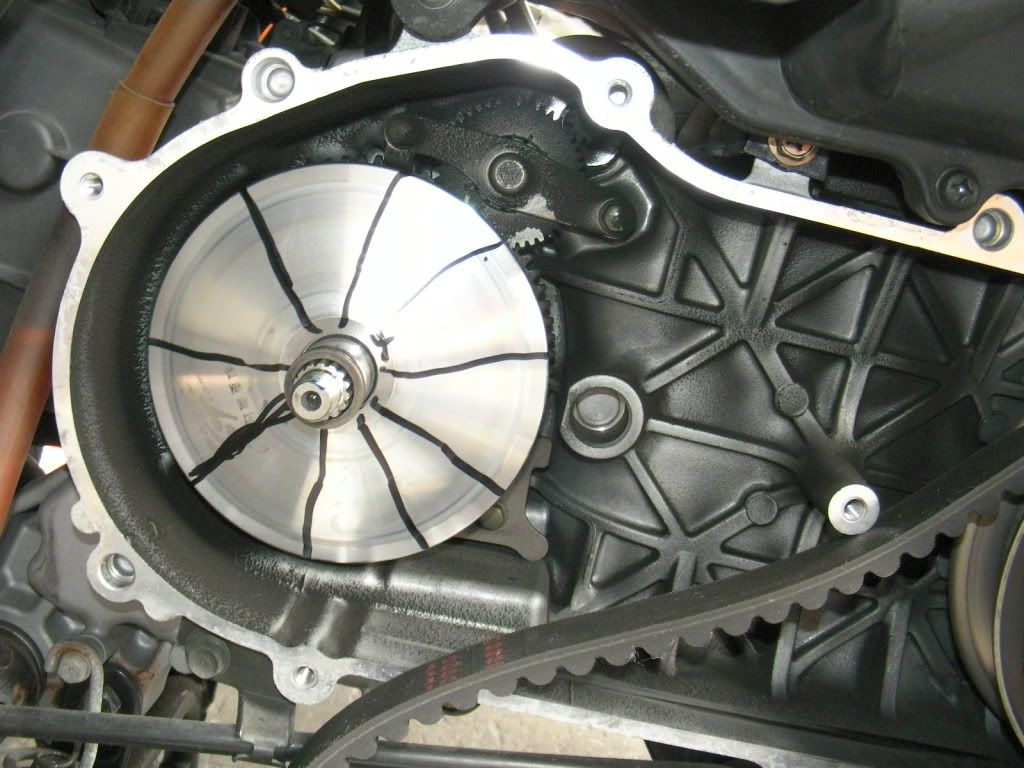

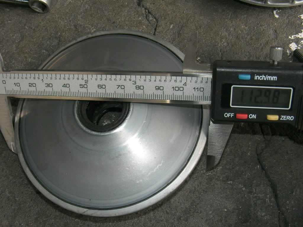

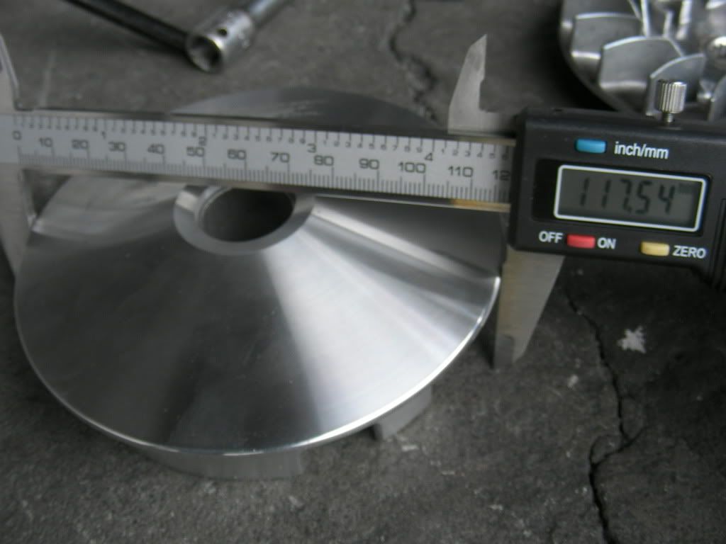

Stock outer daimeter is 113mm
TST outer diameter is 117.54mm
this has a effect on top speed as a larger daimeter allows the belt to ride higher if the rear torque drive allows it, also belt length can play a role.
if you notice the ramp and thickness. the stock one has a shorter ramp since it's outer wall is thick. this has a effect on how far the roller weights will go to push the metal ramp plate. most aftermarket has a longer ramp and outer walls are thinner. this allows the roller weight to roll further out and push the metal ramp plate more and in effect push the varaitor closer to the face drive. all this allows the belt to sit higher for more top speed or better top end.
ELMARKO the variator to double check how high the belt rides up the variator.

also people have asked about the grease seals on the stock variator and why a aftermarket one doesn't.
this item cause more resistence and if it leaks grease will be on the belt that will cause slippage.
taiwan aftermarket varaitors are desgined so it does not require grease. different materials are used so it can slide freely on the boss without drag. just make sure to clean it from time to time as grime can build up and cause it to stick in worst case. if there is too much slack and the boss wobbles in the variator then it's time to change the variator.
