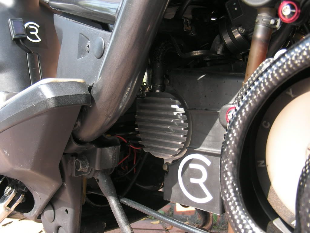

here is a comparison on the oil drain heat sink. it's a neet little widget that actually works. it's made from billet aluminum cut on a 5 axis 3D cnc machine.
difference is quite dramatic at that spot. does it have a effect on the total system i can't say. every little thing helps so it is what it is.
this test was done on the same day, rode on the same path/distance. pull over and take measurements asap while it's idling. i even re-used the same motor oil to try and keep it fair.
File comment: stock drain bolt
File comment: middle of heatsink
File comment: where the engine block touch the heat sink

can you post a pic of this oil drain heat sink

Post Re: RC test mule
:cheers:

oh thats the oil screen bolt
that already comes with some sort of heatsink fins
I thought it was the drain bolt

me and my freinds shops always use that to drain the oil so im use to calling it the oil drain bolt.
not everyone uses that to drain oil and actually use the real oil drain bolt on the side.
