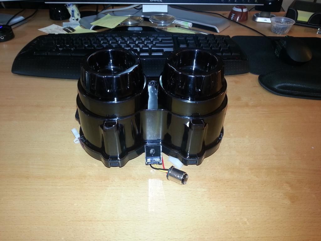

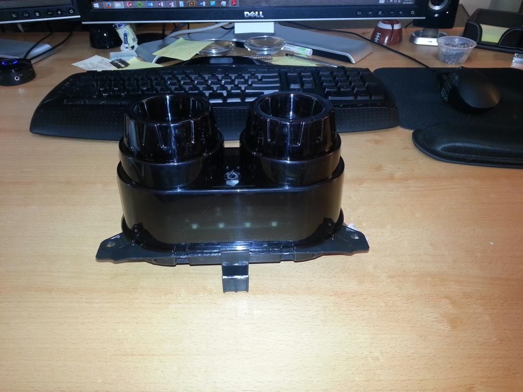

Mine just came in USPS today
Pics as requested
(Edit-seems i missed the previous posts with pics already up)
Seems a stout unit, i'm hoping i'll get to install it tonight and report back (as well as comparison shots hopefully with both lights illuminated to show how much brighter in the same shot)

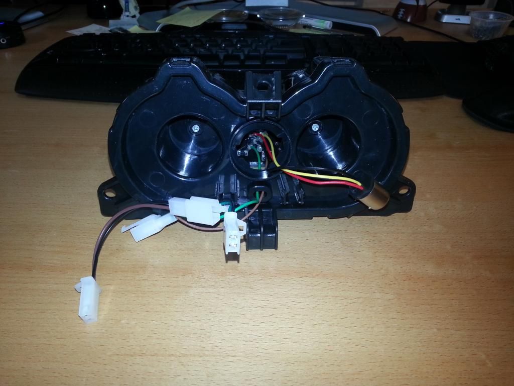

I dont think the real one showed any circuit board in that center hole
I think it had a gray plug
or some way to secure the stock wiring over that hole
then twist on the new connector

The stock bulb socket mounts back in that hole so it's not left open
And as posted, the wires were reversed (Had to swap yellow/red) to get functional brake light (It was lighting up the LEDs on bottom for the tag light when brakes were applied)
Looks amazing vs the stock lights, rode in today so we'll see how it looks in the day light

Correct. I double checked i was connecting the J-socket correctly (High to low pins) and i am 100% certain it's plugged in correct.
When plugging in the factory socket into the adapter plug on the lights, the brake light was on constantly and the white lights were activated with the brake lever
Spliced those and rewired the red/yellow wires together and now the white is on constant and brake lights are activated via the brake lever
