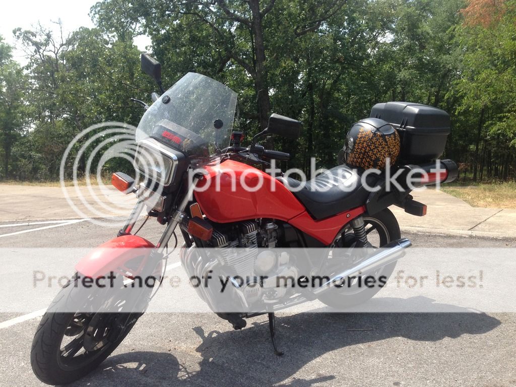

I picked up a decent 1982 Yamaha Seca 750. I had to change to more comfortable bars, and replace the crumbling fuse block. There are a few more things to do before she's road worthy: Rebuild brake MC and Calipers, braided lines, new pads/shoes all around, new tires, check valve clearances and re-shim as needed, replace the slash cut pipes with actual mufflers (ear-bleeding loud at 7k), repair the gauge needles (broken off), convert to a spin-on oil filter, and eventually paint it something other than the current orange.
It's cool what $800 can buy if you look hard enough. I should be in it for less than $1500 once the mechanicals are taken care of.

Well it has been quit a while hasn't it?
Aftr a full recomissioning, I've been riding the Seca (name didnt' stick) for a few years now, including several weeklong trips.
How she looks now (mostly):
I do miss my Zuma, and plan on getting another to build up to my liking once I finish grad-school (grad school at 45....insanity).
Keep on rollin fellas.
