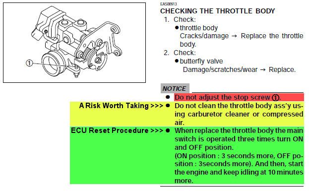

This image was extracted from the Factory Service Manual in regards to Checking the Throttle Body Assembly... According to the FSM, you shouldn't clean or service the Throttle Body Assembly. IMO, as long as you're careful and don't go overboard with the cleaning fluids, you can successfully clean this part contrary to what the FSM states. IMO, the FSM expects everyone to simply fork over $200+ to replace the Throttle Body Assembly just because it's dirty, and that's completely unacceptable if you can save money by getting your hands a little dirty. Also note that the Green Highlighted section from the FSM instructs you on how to properly Reset the ECU and it's ISC Valve settings... The FSM does not specifically state that this is an ECU Reset; however, this is the standard ECU Reset Procedure. Nowhere else in the FSM does it specify how to Reset the ECU without using the Yamaha FI Diagnostic Tool.

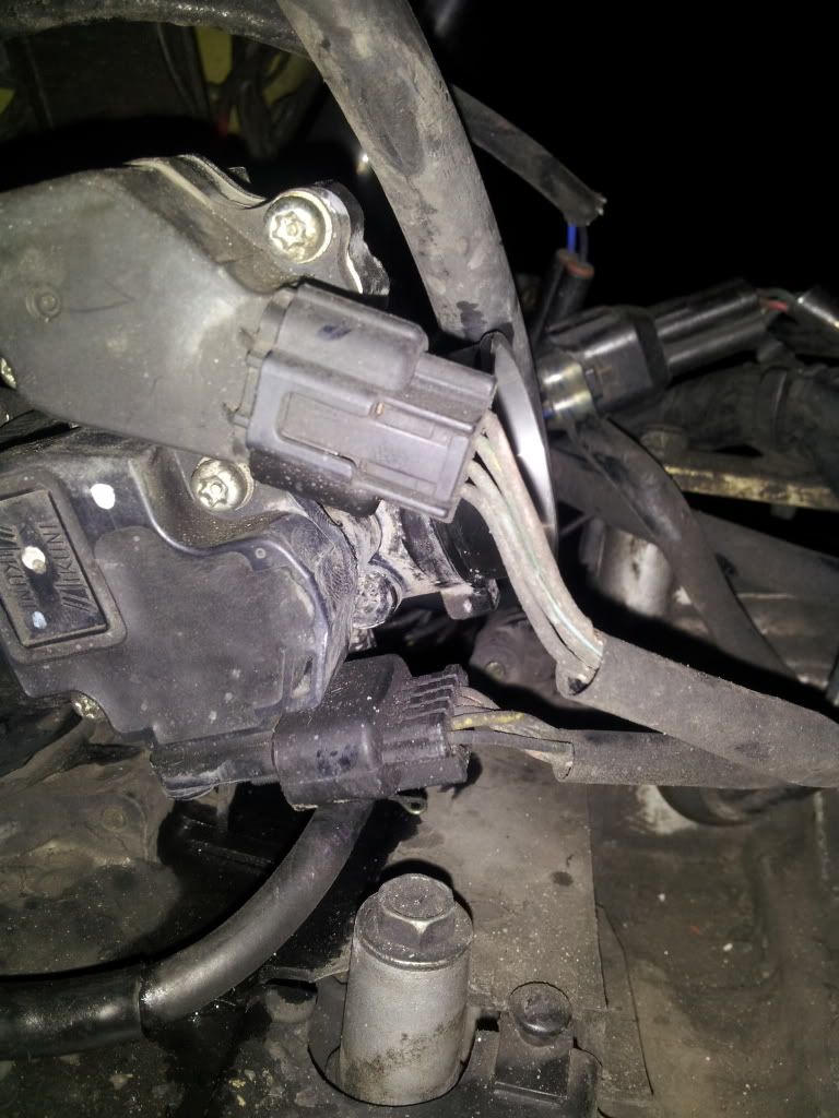

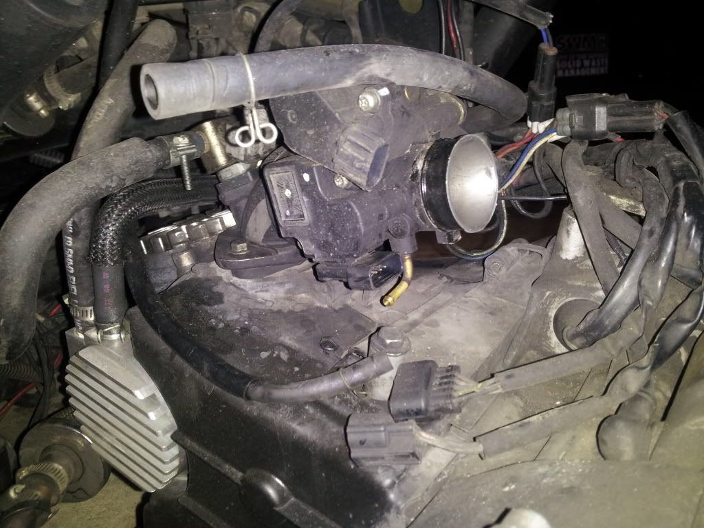

To start the cleaning process you must first remove the Throttle Body Assembly from the scooter. First remove the Air Intake Box by loosening the intake hose clamp that connects the Air Intake Box to the Throttle Body. Followed by removing the black emissions positive pressure/oil vapor feedback hose from the back of the Air Intake Box, and then removing the two bolts at the bottom of the Air Intake Box that mount it to the top of the CVT housing. The Air Intake Box Assembly can now be removed from the scooter.
Next, you'll have easy access to the Throttle Body Assembly and it's hose, wire harnesses, and throttle cables. Start by removing the ISC Valve & IAP Sensor wire harness connectors from the Throttle Body... Simply depress the connector's locking tab clip and pull the connector away from the throttle body. Don't pull on the wire harness as this can damage the wires, always remove the wire harness & connector by pulling on the connector itself. After the wire harness connectors have been removed, you can remove the small hose connected to the brass nipple on the Throttle Body. Place the small hose and wire harnesses out of the way and to the side of the Throttle Body.

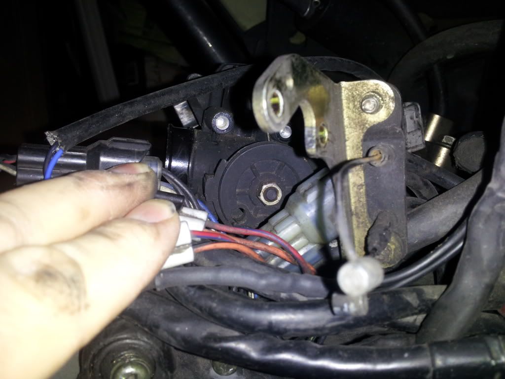

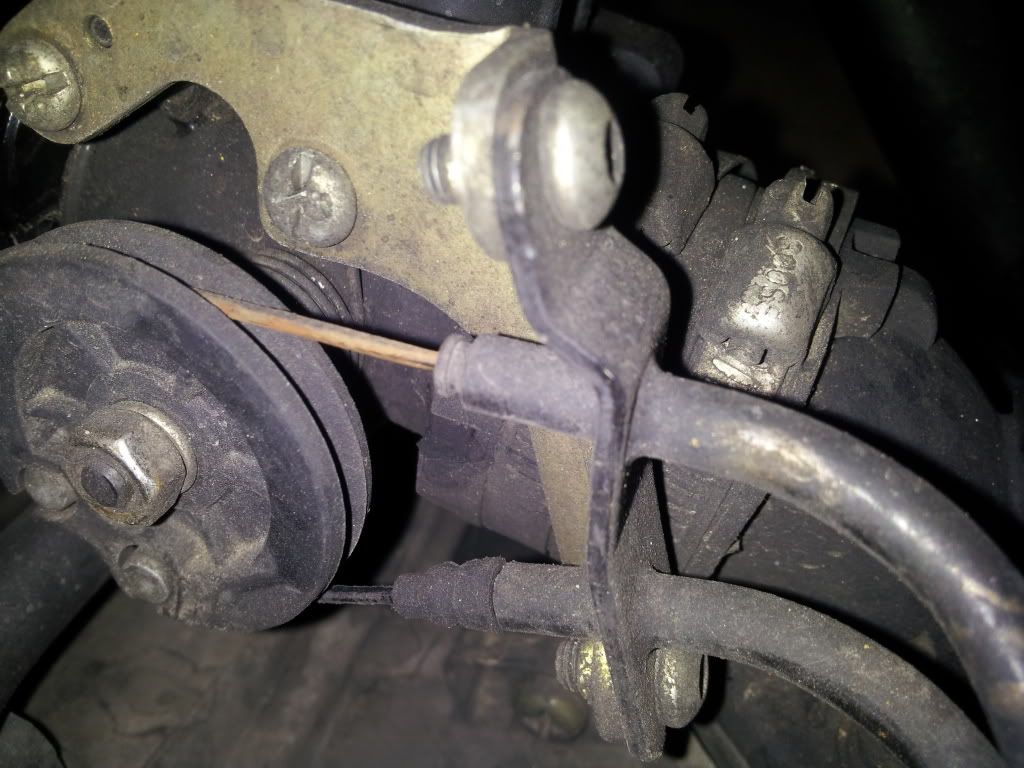

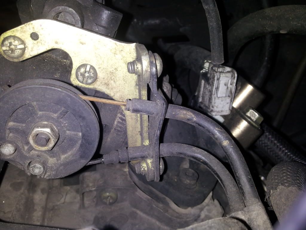

On the other side of the Throttle Body, you'll see the Throttle Cables and it's mounting bracket. There are two ways that you can remove the Throttle Cable Bracket, you can either choose to unscrew the Philips Screws that are shown to the left in the above pic, or you can remove the Allen Hex screws shown to the right. I chose to remove the Philips screws because I had more room to work with vs. removing the Allen Hex screws. With the Bracket removed, you'll now have the ability to maneuver the Bracket and Throttle Cables closer to the Black Throttle Linkage (Black Round Disc that the Throttle Cables are connected to). This should give you plenty of slack to remove the Throttle Cables from the Throttle Linkage. Simply unwind the cable from the Throttle Linkage and slide out the Throttle Cable Locking Pin from the Throttle Linkage as shown below.

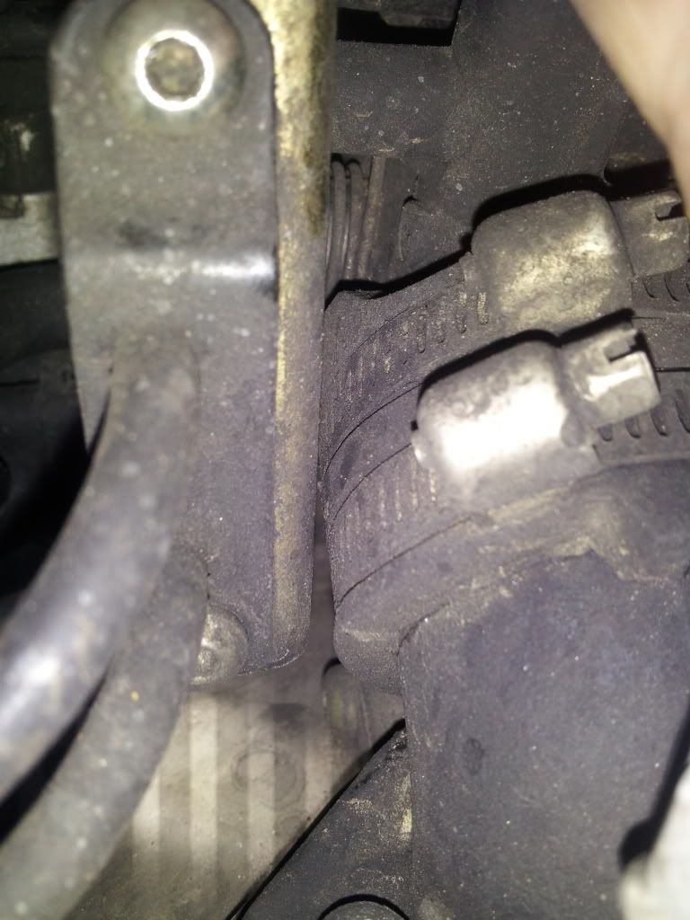

Next you'll loosen the hose clamp that attaches the Throttle Body to the Intake Manifold. In the photo shown below, you'll see there are two hose clamps, you only have to loosen the hose clamp that's furthest away from the Throttle Body... It's the hose clamp that clamps the hose down to the Intake Manifold. You do not have to remove the intake manifold, so don't bother wasting your time with it. Once the hose clamp is loose enough, you should be able to pull the Throttle Body Assembly off the Intake Manifold and away from the scooter.

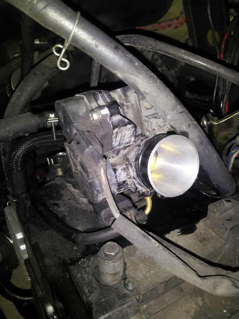

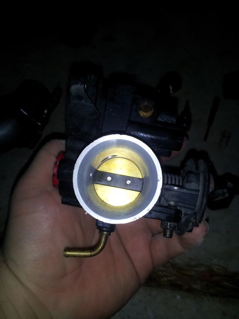

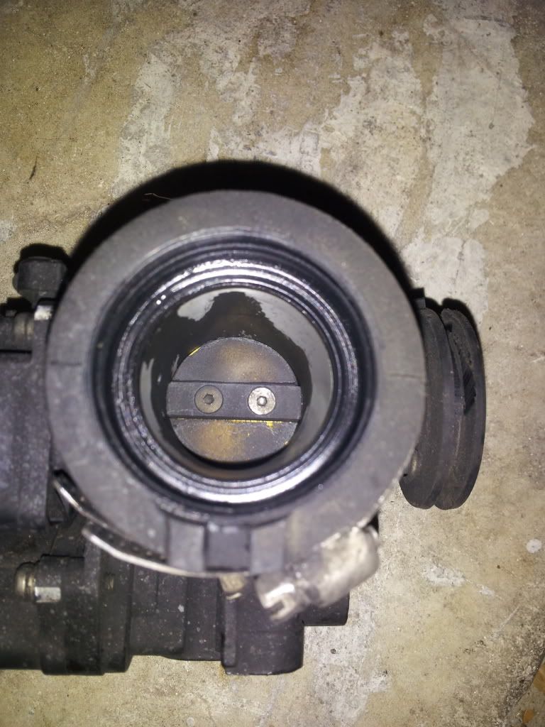

With the Throttle Body Assembly removed from the scooter, you'll be able to inspect it and clean if necessary. Here are the photos before I cleaned the Throttle Body...
Air Intake Box end of the Throttle Body:
Intake Manifold end of the Throttle Body:

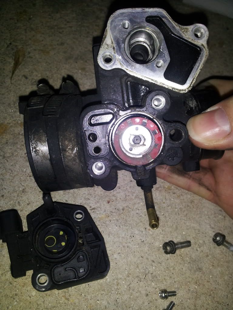

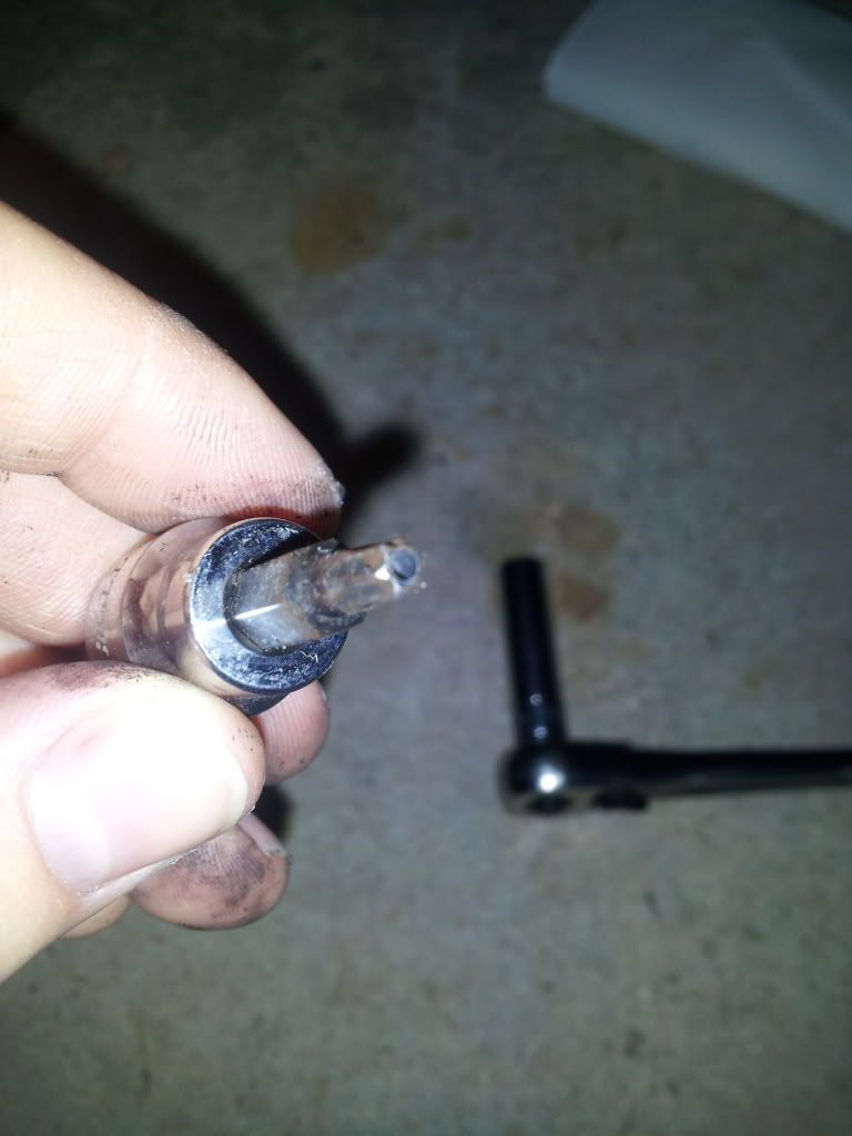

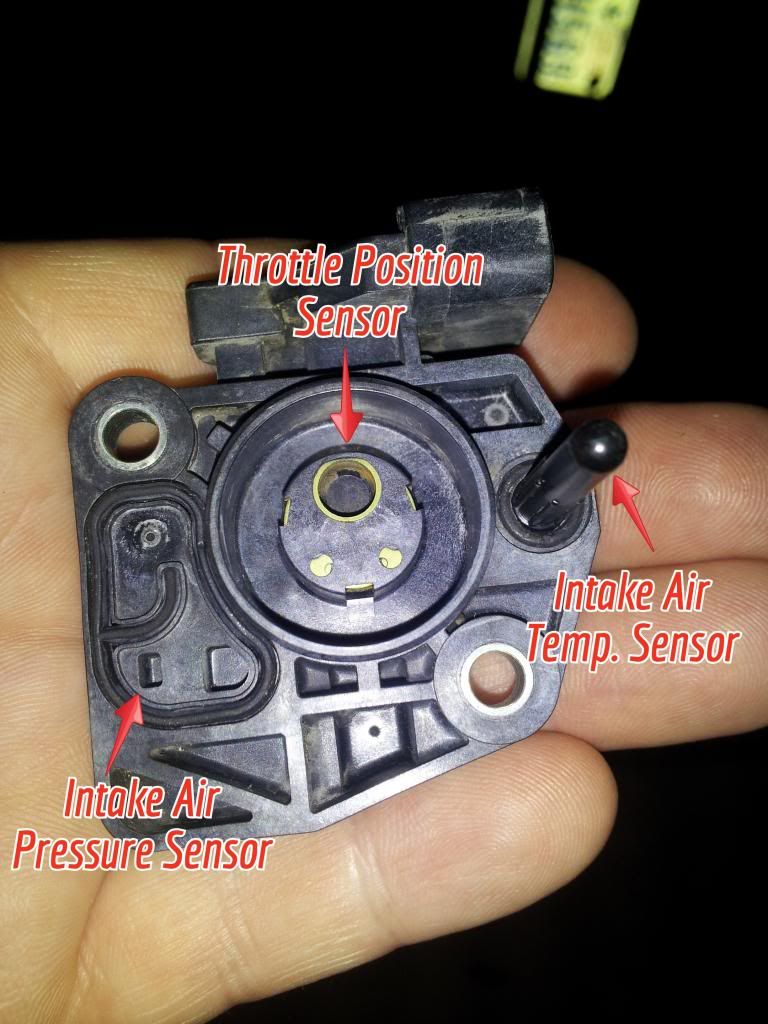

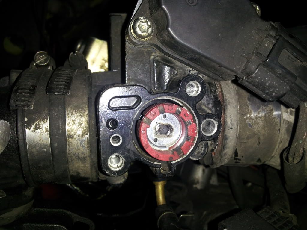

Before cleaning the Throttle Body, You must remove the ISC Valve and the IAP Sensor. These components of the Throttle Body Assembly require a Security Torx bit to remove the Tamper Proof Torx Screws. A Security Torx Bit has the standard Torx Star Pattern with a hole in the center of the end of the bit. The Security Torx Bit I used was a T20 to remove the 4 screws that hold the ISC Valve & IAP Sensor to the Throttle Body.
At this point, whenever you're handling the ISC Valve or the IAP Sensor you should pay close attention to the small parts, o-ring, and gaskets. You should know that these components can only be replaced by purchasing a new $200+/- Throttle Body Assembly as these components are not sold separately.

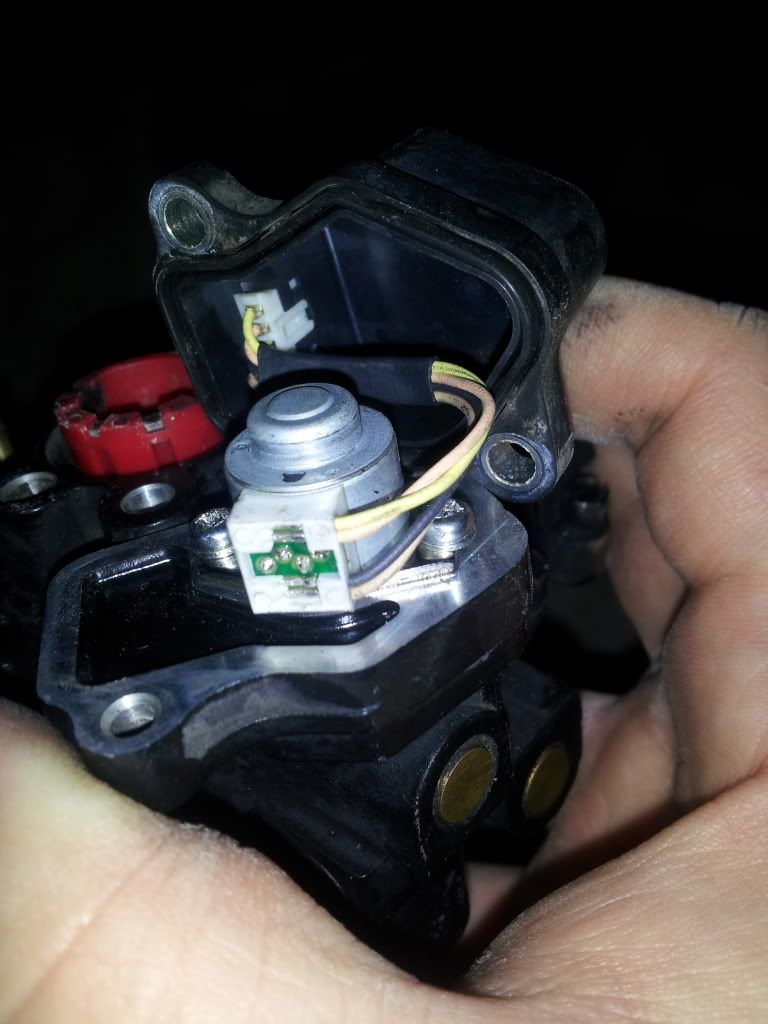

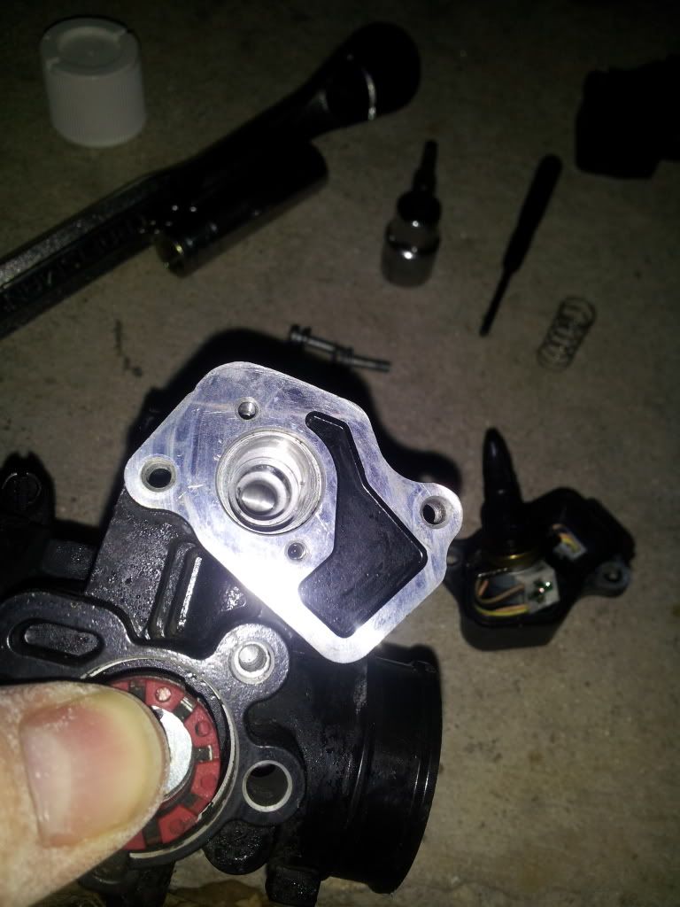

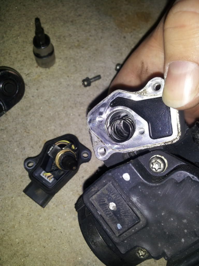

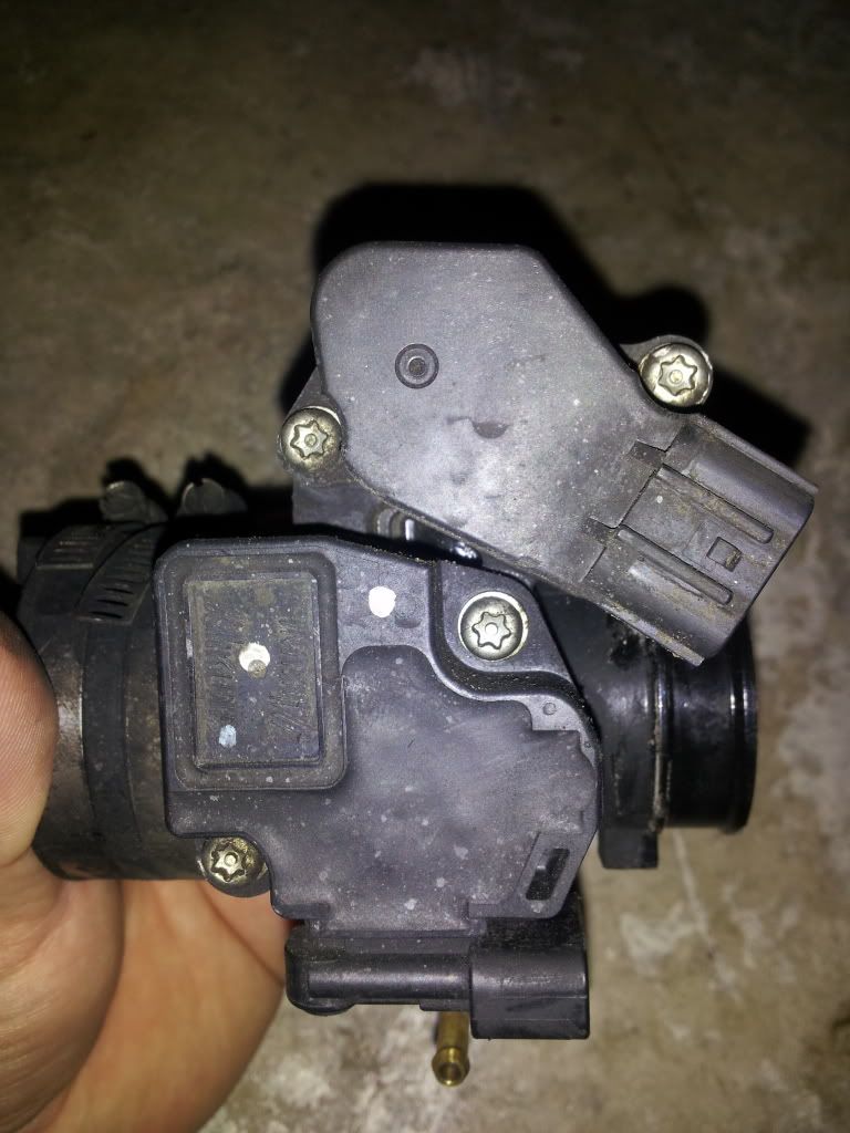

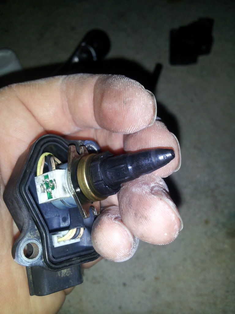

When you remove the ISC Valve's Tamper Proof Torx Screws and separate the black plastic cover, you'll find that the ISC Valve's Solenoid is also mounted to the Throttle Body by two small Philips Screws. You'll need a Small/Precision Philips Screw Driver to remove these two screws. Be careful not to strip these screws. Also, be aware that the ISC Valve Black Plastic Cover has a rubber gasket that can be easily damaged if you're not careful with it while handling these parts. Once the two small Philips screws are removed, you'll be able to remove the ISC Valve & Solenoid from the Throttle Body. There is a small Spring on the end of the ISC Valve, be careful not to damage or lose this spring when removing the ISC Valve.

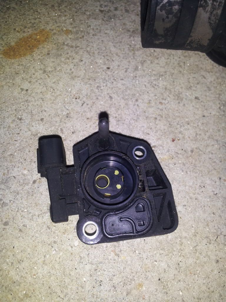

Next you can remove the IAP Sensor by removing the two Tamper Proof Torx screws that mount it to the Throttle Body. Once the two screws are removed, the IAP Sensor can now be gently removed from the Throttle Body. Pay close attention to the small o-ring at the base of the plastic Air Pressure Sensor so that you don't lose this part. Also, there is a small complex gasket that exists on the opposite end of the IAP Sensor. This gasket can be easily torn or lost, so be careful with it as well.

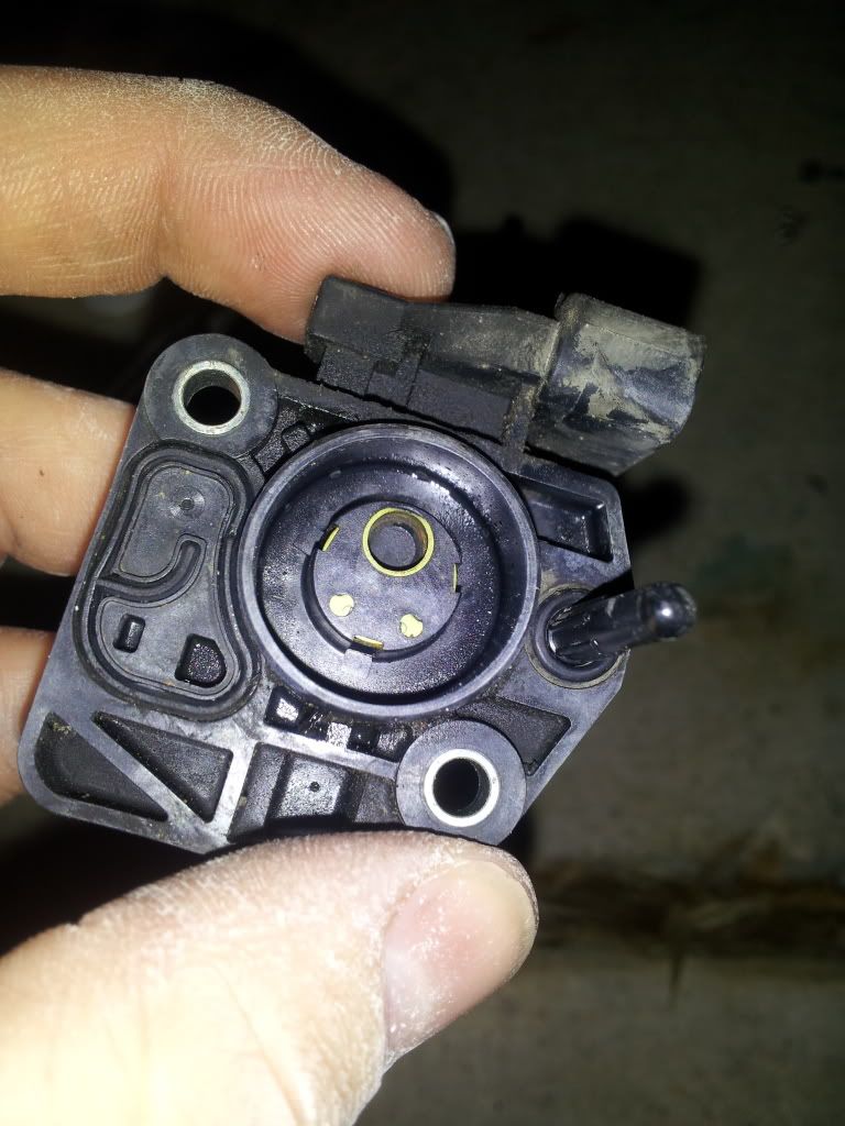

With the ISC Valve and IAP Sensor removed from the Throttle Body, you can now clean these parts. I suggest that you wear rubber nitrile gloves to keep the cleaner from burning your hands. I sprayed the IAP Sensor directly using the Carburetor/Throttle Body Cleaner and wiped away the excess oil/grime with a cloth/paper towel. Be careful not to damage or lose the gaskets or o-ring in the process. You don't want to soak the sensor in cleaning fluids as this can potentially damage the sensor... simply spray it down to get the majority of the loose oil/dirt/grime off the sensor and then wipe away the rest. It may be useful to clean the smaller crevasses with a q-tip or similar cleaning implement. Once it's wiped clean (doesn't have to be perfect, just clean it as gentle and as best as you can), you can set it aside to air dry for a few minutes. If the crevasses (especially the ones inside the gasket) are not completely dry, go ahead and try to soak up the remaining cleaning fluid with a small piece of paper/cloth towel or a small wad of tissue paper.
Here is the cleaned IAP Sensor: (Note: it's not perfectly clean, but good enough IMO)

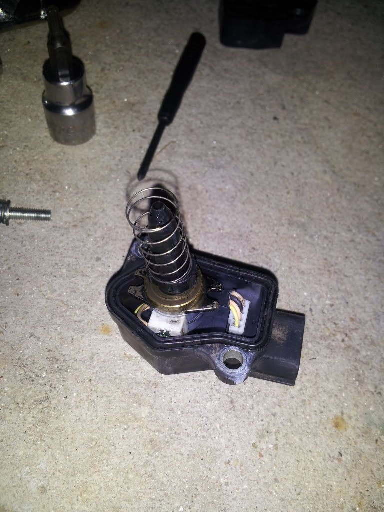

The ISC Valve can be cleaned by directly spraying it with the Carburetor/Throttle Body Cleaner, just avoid spraying the solenoid and it's wires and the black plastic cover. In the photo shown below is the ISC Valve... The part that you'll need to clean is the brass disc (it slides back and forth on a needle thin shaft that is mounted inside the black plastic cone. The Black Plastic Cone is in a fixed position, you should clean both the inside and outside of this Cone by spraying it with carburetor cleaner. Be careful not to spray the circuitry or the back side of the Solenoid (the part that has the wires protruding from it). If you do end up spraying the Solenoid, simply dry it off completely before reinstalling the part. The Solenoid is basically used to move the Brass Disc either closer or further away from the Black Plastic Cone along the needle thin shaft. Spray the Disc and both ends of the shaft it slides on with Carburetor/Throttle Body cleaner. After the ISC Valve is cleaned, allow the part to completely air dry for a few minutes and move on to cleaning the the Throttle Body.
The ISC Valve Spring was also kind of dirty, so I suggest cleaning it as well... Simply spray the spring with the Carburetor/Throttle Body Cleaner and gently wipe away any grime that is still on it.
Here is the cleaned ISC Valve:

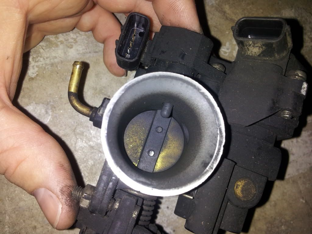

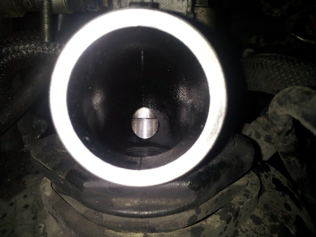

Next, you'll clean the Throttle Body. For this I recommend using the Carburetor/Throttle Body Cleaner to spray down the inside and outside of the Throttle Body as well as any ports that are used for the ISC Valve and IAP Sensor. A q-tip can be used to get inside the ISC Valve and IAP Sensor ports on the Throttle Body, and then use a cloth or paper towel that is soaked in Carburetor/Throttle Body cleaner to wipe down any areas of the Throttle Body that aren't easily cleaned by just spraying them down. Usually the Throttle Body Butterfly Valve and the areas next to it need wiped down. Thoroughly inspect the entire Throttle Body to see if all areas and crevasses are properly cleaned. Set the Throttle Body aside to air dry for a few minutes.
Here is the cleaned Throttle Body:
Air Intake Box end of the Throttle Body...
Intake Manifold end of the Throttle Body...
Cleaned ISC Valve Ports on the Throttle Body...
Cleaned IAP Sensor Ports on the Throttle Body...

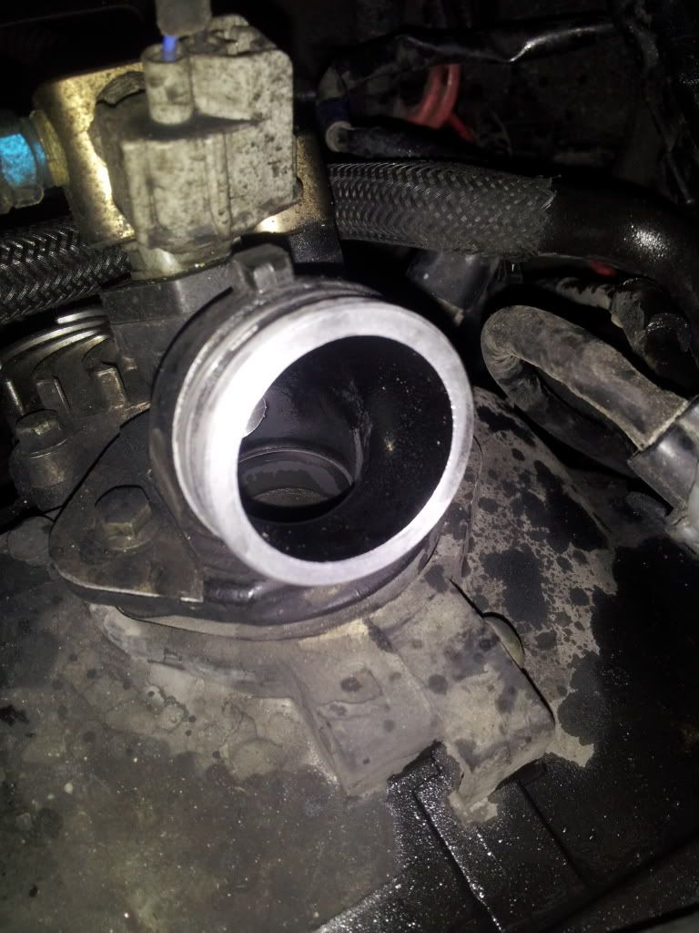

While the Throttle Body and other components are air drying, you might as well clean up the Intake Manifold. I used a cloth towel and sprayed the towel with Carburetor/Throttle Body cleaner and then proceeded to wiped the inside of Intake Manifold with the cloth towel until it looked visibly clean. I cleaned the inside of the Intake Manifold while it was still mounted to the motor. This part does not need to be removed in order to clean it. Be careful not to spray inside the intake manifold unless you plan to thoroughly clean the intake valves as well. If you do spray Carburetor/Throttle Body Cleaner into the Intake Manifold and thus onto the Intake Valves, then you will have a hard time starting up the scoot on it's first start up after you re-install all the parts. If you do have a hard time starting up the scoot due to excessive cleaner on the intake valves, simply apply WOT or a large amount of Partial Throttle while starting up the scoot. It may take several tries, but eventually it will start up. You should also give it a bit of Throttle to help burn off the excessive cleaner in the combustion chamber.
Here's the cleaned Intake Manifold:

Now that you've completed the process of Cleaning and Re-installing the Throttle Body Assembly, you must perform the ECU Reset Procedure as shown in the first image of this How-To. The instructions can be a tad confusing the way they are written in the FSM, so I will clarify them below...
ECU Reset Procedure:
Start this procedure with the Side Stand in the Up position (you can optionally place the scooter on the center stand). With the Key inserted into the Ignition in the Off position, toggle the Key to the On position for 3 seconds (do not Start the motor), then toggle the Key to the Off position for 3 seconds, followed by the On position for 3 seconds and then Off position for 3 seconds, followed by the On position for 3 seconds and then Off position for 3 seconds. (The On/Off Toggle should be at least 3 times each for On & Off) Next toggle the Key to the On position for 3 seconds and then Start the motor. Let the motor idle for at least 10 minutes prior to giving it any throttle.

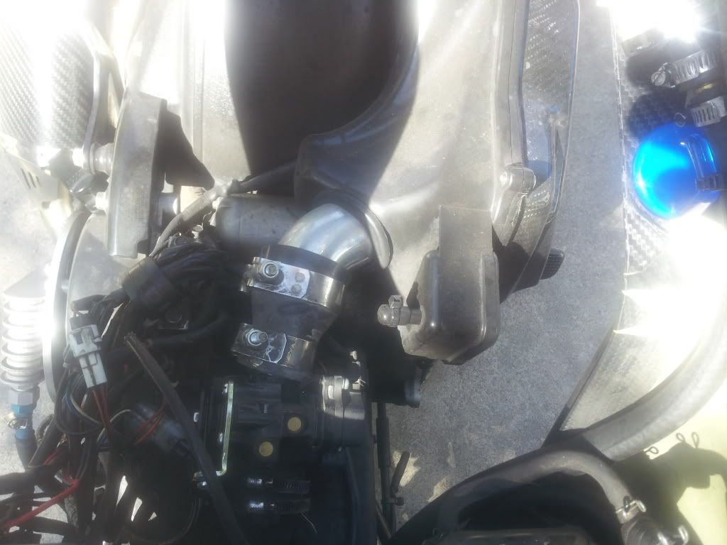

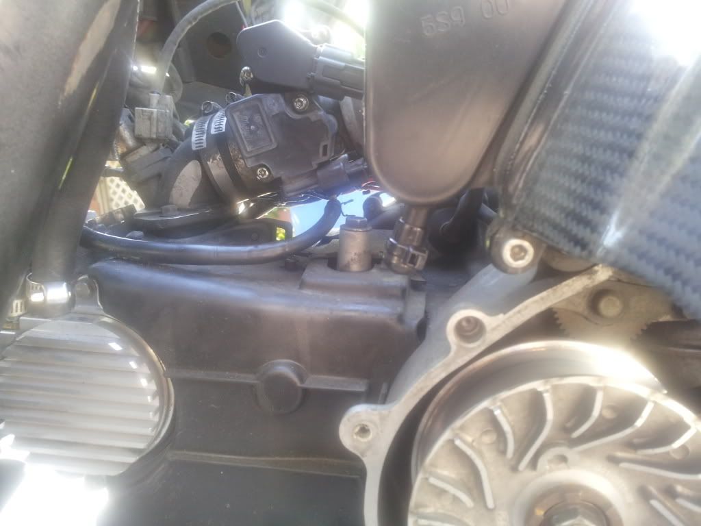

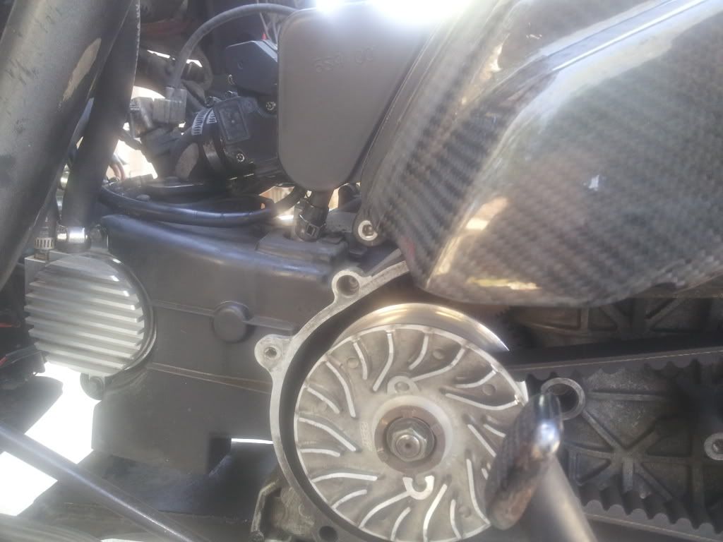

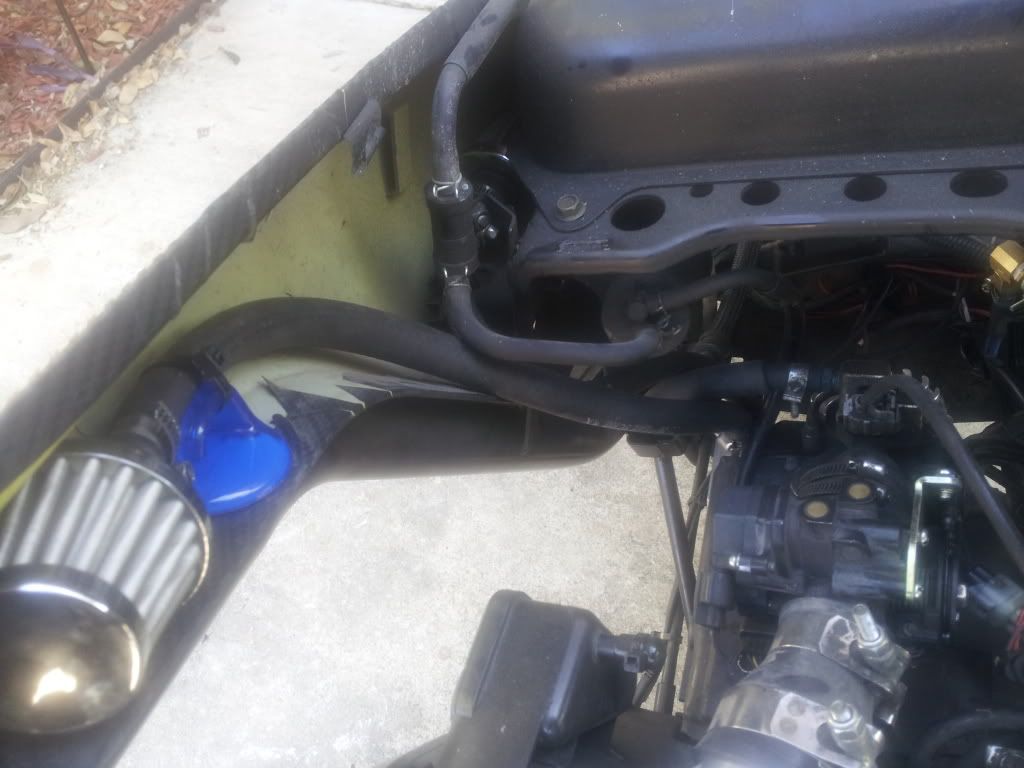

First disconnect the transparent OEM oil catch hose and the black oil vapor hose that are connected to the front end of the Intake Air Box... Once disconnected, cap the nipples and zip tie the caps tightly to keep them secured to the nipples.
Next, attach a new hose that fits the nipple on the top of the Cam Cover on the left side of the motor, the size of the hose inner diameter may be different between various Cam Covers. If you have two vents/nipples on the cam cover, then you will need two hoses, one for each vent on the cam cover.

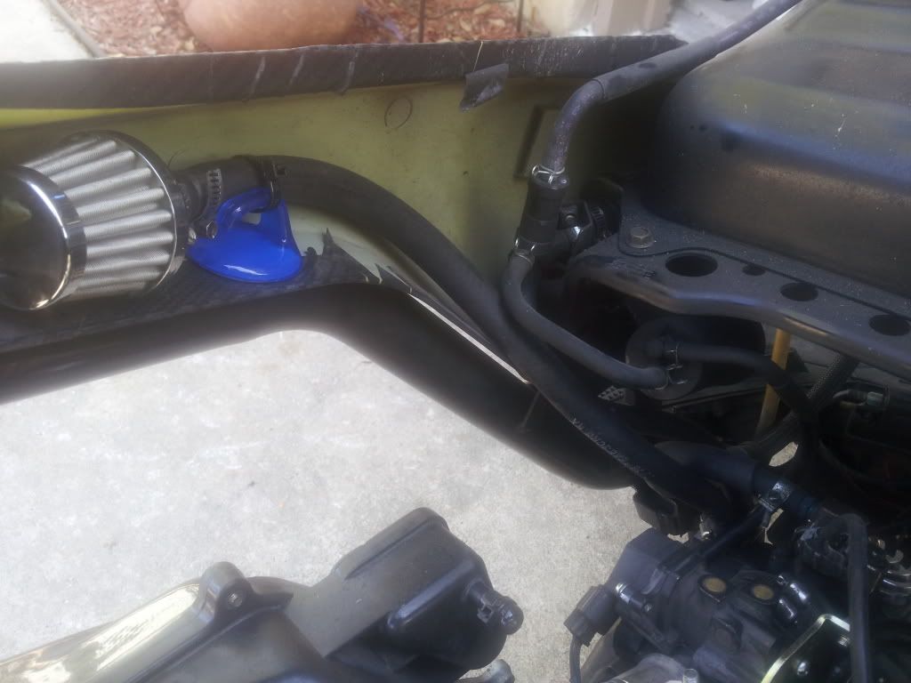

With the saddle & trunk removed, you can route the new oil hoses up to the left side panel as shown in the pics... I have two vent hoses, so I routed one hose and breather filter forward so that it is next to the fuel tank and the other back towards the rear. I used an adhesive backed wall hook to help secure the hose to the side panel. I also zip tied the hose to the blue hook that I added. Be sure to clean the inner surfaces of the side panel prior to adhering the wall hook to it... otherwise, the dusty/dirty surface will prevent the wall hook from securely adhering.
The hose next to the fuel tank has a breather filter attached as well... its difficult to see the filter and hose, but it is just behind the fuel tank tip over sensor/vent valve seen in the photo below. The hose is routed just beneath the other oil/pressure vent hose that is routed towards the rear on the side panel. I zip tied the hidden hose to the side panel mounting point that is located next to the fuel tank.

Post Re: How-To: Clean Throttle Body, ISC Valve, and IAP Sensor
Nice pics man. Thank you.
I have a couple questions though.
First: Would the stock black hose from the camshaft breather just hook up to a breather filter and could get placed behind the cover on the opposite side of the bike to avoid having to get new hoses and make sure they fit?
Second: The original problem I was having was the transparent oil vapor tube was full of oil after about 4,000miles of riding. Where will this oil/oil vapor be going? into that breather filter? Wont this just be spraying the inside of my side cover?
The OEM Black vent hose is molded into a specific form, so there's not much you can do with it other than alter the direction that the hose is placed. A new hose can be acquired at any local auto parts store. You can take your OEM hose in, and have them match the inner diameter to the hoses that they carry. With 1.5ft of new hose you should have plenty of hose length for one vent port, and double that length for two vent ports. Cut the hose to size when you're installing the breather filter. I picked up my breather filter (Stainless Steel Mesh) at a local Pep Boys auto parts store (O'Reilly Auto Parts stores also carry it). I chose the Stainless Steel Mesh breather filter to prevent the oil vapors from soaking the filter media like what happens with the traditional standard cloth filters. You'll need some hose clamps (x2 for each hose), and a two-way brass (or plastic) coupling fitting to connect the hose to the breather filter. I used a 3/8" hose two-way coupling fitting.
The oil collected in the OEM transparent oil catch hose, is accumulating there because the stock vent hose is not at a vertical angle... it's more at a horizontal angle after the initial 90 degree rise at the vent port on the cam cover. If you install the hose(s) and breather filter(s) as shown in the pics, it will not spew oil all over the scoot. Most of the oil vapor will collect on the walls of the hose or at the filter and condense from a vapor into a liquid. Gravity will return the oil back into the motor. If your BBK is setup for high compression or is larger than the standard 155-164cc BBKs, then it may produce more oil blow-by vapors and spew out the top of the vent hose. Most of us don't have to worry about this issue. I have a higher compression 155cc BBK since I used the thin cylinder gasket instead of the recommended thick cylinder gasket... I still don't have oil spraying all over the scoot from the vent hose. The only time that happened for me was when I forgot to attach the vent hose to the cam cover nipple and started up the scoot.

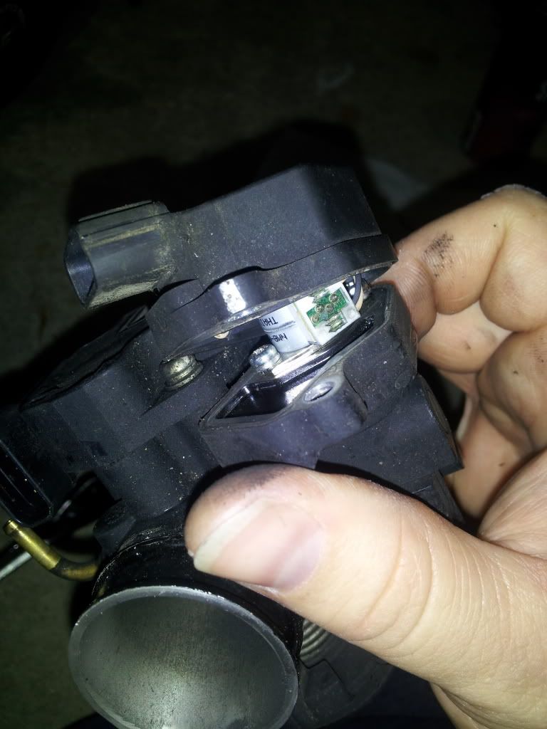

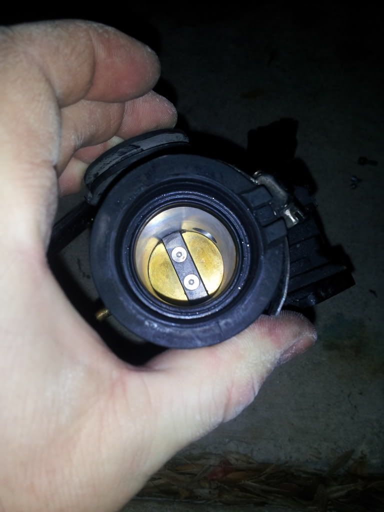

Hi
Guys does anyone knows where can i buy a tps dame as the one in picture.
Mikeali wrote:
Hi
Have you tried Ebay? I see there are some innexpensive Throttle body units on there
Davethestick wrote:
Mikeali wrote:
Hi
I tired all were different

Does anyone know if the 2013 BW's 50f has the spring in the ISC valve? I open one and there's no spring. :(
